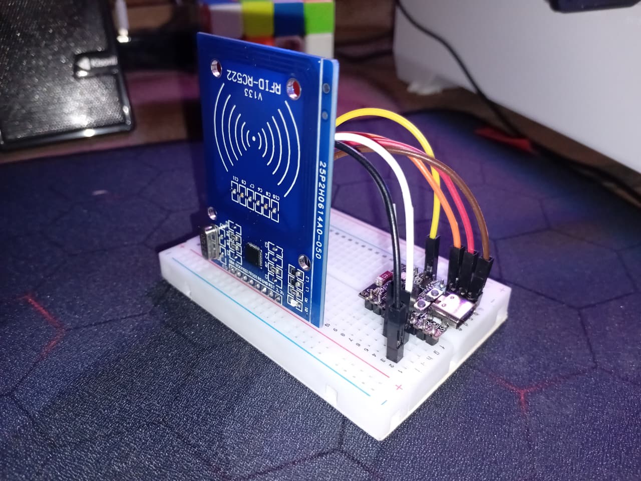

Hi, just dropped a small firmware project on GitHub that I've been sitting on for a while.
Basic idea: ESP32-C3 + RC522 module, plugged into USB, and it just sends card scan events as JSON over serial. Your host (whatever it is -- Python script, Node, a Rust binary, doesn't matter) is the one that decides if the card gets access or not. The firmware doesn't know and doesn't care about your access list. :lol:
So when someone taps a card you get:
{"event": "card", "uid": "HE:LL:O6:67"}
:P
You reply with:
{"method": "POST", "resource": "access", "data": {"access": true}}
LED blinks, done. If you don't reply in time it blinks a different pattern and moves on.
There's also a handful of other endpoints -- GET /status, PUT /config for tweaking debounce and timeouts at runtime, PUT /led if you want to drive the LED yourself, POST /reset, etc. All single-line JSON over USB CDC at 115200.
Hardware side is pretty cheap. ESP32-C3 Super Mini is like $2 shipped, RC522 is another $1-2. Five SPI (+one more for 3.3v) wires plus one LED pin and you're done.
Built with PlatformIO. GitHub Actions handles CI and spits out a merged .bin (bootloader + partitions + firmware all in one) so if you just want to flash and not deal with the build toolchain, grab it from Releases and use esptool or the browser-based esptool-js.
Repo: https://github.com/lenzarchive/esp-rfid-bridge
Let me know if anything's broken or if the protocol is missing something obvious. :)
