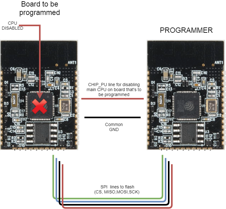

Is there a way to use an ESP32 as an ISP for another ESP32?
I have managed to access the external flash of the board that needs to been programmed, by exposing it's pins and disabling it's CPU (by tying CHIP_PU line to GND). This way the external flash memory that needs to be programmed it's not tied to it's main ESP32 chip and it's free to be accesed via SPI by another ESP32.
I've tried simple commands like reading the JEDEC ID (0x9F) and they do work.
However I haven't been able by now to find any way to write the main bin files (bootloader.bin, partitions_singleapp.bin, example.bin) using the ESP32 programer board as an ISP.
Here is a visual representation of the system:

What's your question exactly? The only one you actually ask is 'is there a way to program an ESP32 from another ESP32', which has the quite predictable answer 'yes there is, you seem to be on your way to implement one of them'. The implicit one in the rest of your story seems to be 'why can I send simple commands but not program the chip', and there's not enough information to even start answering that question.

A slight suggestion in the right direction would be greatly appreciated; in case you need further info I'm here to provide it.
A good starting point would be:
The question in cause would be: do you know of any way to load those bin files to the target system using the programmer board?However I haven't been able by now to find any way to write the main bin files (bootloader.bin, partitions_singleapp.bin, example.bin) using the ESP32 programmer board as an ISP.

1) The programmer can be any ESP32 board out there, but for reference I use a Sparkfun ESP32 Thing as the main programmer along with a shield which routes the SPI pins of ESP32 Thing + CHIP_PU + 3V3 + GND to some tactile pads. Those pads are the ones which interface with the board that needs to be programmed.
2) The "Board to be programmed" is a custom PCB design which exposes the external SPI flash pins on some pads for ease of access. These pads come in contact with the tactile ones mentioned at 1). The purpose of disabling the CPU of the programmed board is to release the flash from being used by the programmed board, thus avoiding a conflict on the same resource (which is the serial flash). (ESP32 and the serial flash IC share the same 3.3V power supply).
3) The problem over here does not relate to concomitent access to the flash (the board that needs to be programmed has its main CPU disabled); it releates to uploading the bin files to the external serial flash using the ESP32 as an ISP
Such a jig that you mention it's actually the programmer on my system which has some tactile pads that connect to the SPI flash interface on the board that needs to be programmed.
I do have the UART pins exposed on the tactile pads, but the goal is to program the serial flash via SPI.
To simplify this hole process imagine this:
You have an SPI serial flash connected to a generic ESP32 dev board via SPI. How do you upload the binaries (bootloader.bin, partitions_singleapp.bin, example.bin), to their respective addresses (0x1000, 0x8000, 0x10000)?

It would be easier to hold the esp32 on the programmer board in reset and connect the USB uart pins to the target board but maybe you had a reason not to do that

Thanks for the link! I was experimenting with https://github.com/Marzogh/SPIFlash
However, UART programming is not an option for the project I'm trying to develop; if it was I wouldn't have bothered with this setup.
SPI flash programming using an ESP32 programmer board is the goal in my case.
