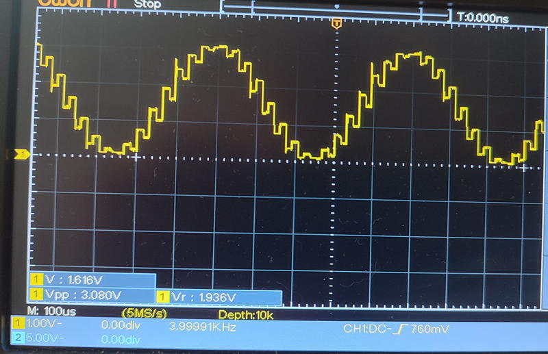

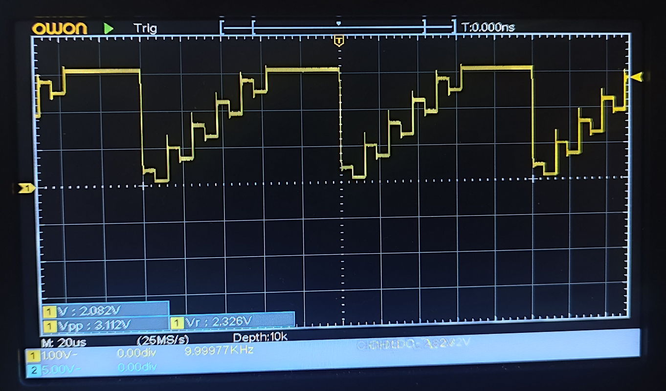

I'm programming my ESP32 using Arduino-IDE. I want to use DAC in continuous mode (DMA mode) with cyclical writing to create waveforms. Therefor I'm creating a buffer-array (type: byte) containing the 8-bit values the DAC should output. But there's a significant problem: The output swaps 2 values of the buffer, so buffer[1] is output first, followed by buffer[0], then buffer[3] followed by buffer[2]. Probably the reason is the 8bit-DAC is using 16bit-I2S for DMA and this leads to the swapping.
Ok, I could just simply swap the values within my buffer to get the correct signal. But I want to keep them in their correct order and instead asking how to solve this issues by ESP32's DAC-API commands? Any ideas?

Postby SamCem » Thu Apr 09, 2026 10:37 am
Btw, the same issue if using "Normal, synchronous writing" by command "dac_continuous_write()":
