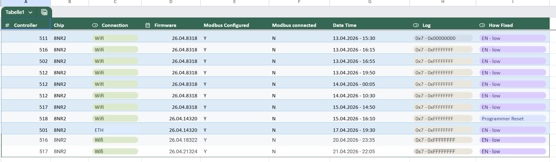

Our hardware has successfully passed EMC/EMF testing conducted by a certified European laboratory, and this issue was not observed during those tests. During those tests all available interfaces where activated in parallel.
At present, we are testing 17 boards running the same firmware. The issue occurs randomly, sometimes 4 days without any crash, and then 1 crash/day on different boards. The time the crash happens is also random, sometimes it happens 5 minutes after start, on other controllers after 2 weeks without reboot. No external devices are connected during testing (such as Modbus interfaces or relay shields, although the connectors are available on the board). Despite this minimal setup, the issue still occurs. Also overnight when no one is near them.
The boot-stuck issue occurs before the ESP32 idle task running i.e., MQTT (TLS 1.2) connected and Modbus polling but no external device is connected.
We are also using a PSRAM-enabled variant: ESP32-WROOM-32E-N8R2 (8MB flash, ESP32-D0WDR2-V3), and we are observing a similar issue on this module as well.
We have already monitored & checked all strapping pins and power supply and haven't found any concerning values.
Additionally, we have observed that after pulling the EN pin low (reset),after some time the booting process logs appear, and the device eventually boots successfully. This is our latest observation.
We have attached a snapshot/document capturing the controller failure logs for your review. Kindly check.
