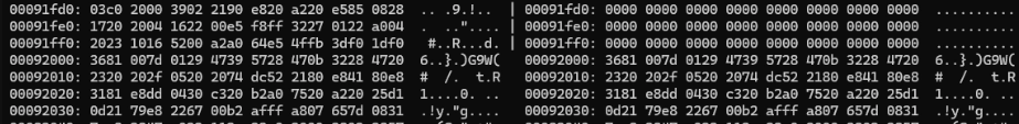

I am working on a product based on ESP32-U4WDH using ESP-IDF v4.4.4. We have more than 2000 devices deployed with same firmware, and recently one device failed in the field.
After retrieving the device, I found that a large region of flash had been overwritten with 0x00.
Observed Flash Corruption
  • Flash contents from 0x9000 to 0xA2000 were all 0x00
  • Everything after 0xA2000 was intact and correct
  • Unfortunately, I could not read contents before 0x9000 when the device was available
  • 0x9000 corresponds to the start of the NVS partition, but the corrupted region extends far beyond the NVS size
  • The boundary at 0xA2000 is clean — no partial corruption at the edge
    (left: expected content in flash, right: contents dumped from ESP32's flash. address starts at an offset so it does not show 0xA2000)

That's not an easy fault to get... assuming no hardware issues, something in the software had to load up those zeroes into the flash and write them, so that's multiple stages of failure (rather than e.g. flash erase, where you don't have to load the ff's). Do you know if the flash of the affected device otherwise is OK?

I reflashed the firmware on the affected device, and it is now working normally again, so it appears that the flash hardware itself is still functional.
However, I am trying to understand what could have caused the contents to be overwritten with 0x00.
The firmware partition starts at 0x10000, and I observed that the flash contents were set to 0x00 up to 0xA2000. This means that more than the first half of the firmware image was overwritten with 0x00.
Given that the corrupted region includes part of the firmware itself, is it possible that the running firmware could have caused this kind of overwrite?

Not trivially. For one, most (all?) of the flash writing functions have guards that stop them from erasing/overwriting the app (see CONFIG_SPI_FLASH_DANGEROUS_WRITE menuconfig option). Secondly, I'd expect any flash writes to happen through the partition API, which has its own checks to see if writes are in-bounds for the partition addresssed.

CONFIG_SPI_FLASH_DANGEROUS_WRITE is set to "Aborts" in my menuconfig, and I am only using standard ESP-IDF APIs for flash read/write — no low-level function calls. Given this, would it be reasonable to assume that unintended writes outside defined partitions are unlikely, or are there still scenarios where this protection could be bypassed?
Also, since the affected region contained 0x00 (not 0xFF), what mechanisms could cause such a large contiguous region to be written with 0x00?
Could this also be caused by a hardware-related fault, and if so, what specific types of hardware faults (ex. power-related faults) could result in this behavior?
Are there any specific stress tests or fault-injection methods you would recommend to help reproduce this type of failure in the lab?

I'd say so. It's hard to give an absolute 'software can never have been the issue here' - you could for instance have a dangling callback pointer pointing to the middle of a flash write routine, which when called causes the routine to immediately start writing garbage - but it seems vanishingly unlikely to me.
Flash writes with data of all 0s would do that. Nothing else to my knowledge.
Yes, for sure. Glitches in the power supply can make microcontroller cores do weird things. Reproducing it would generally be very hard, though, as a glitch would need to happen at exactly the right time.
