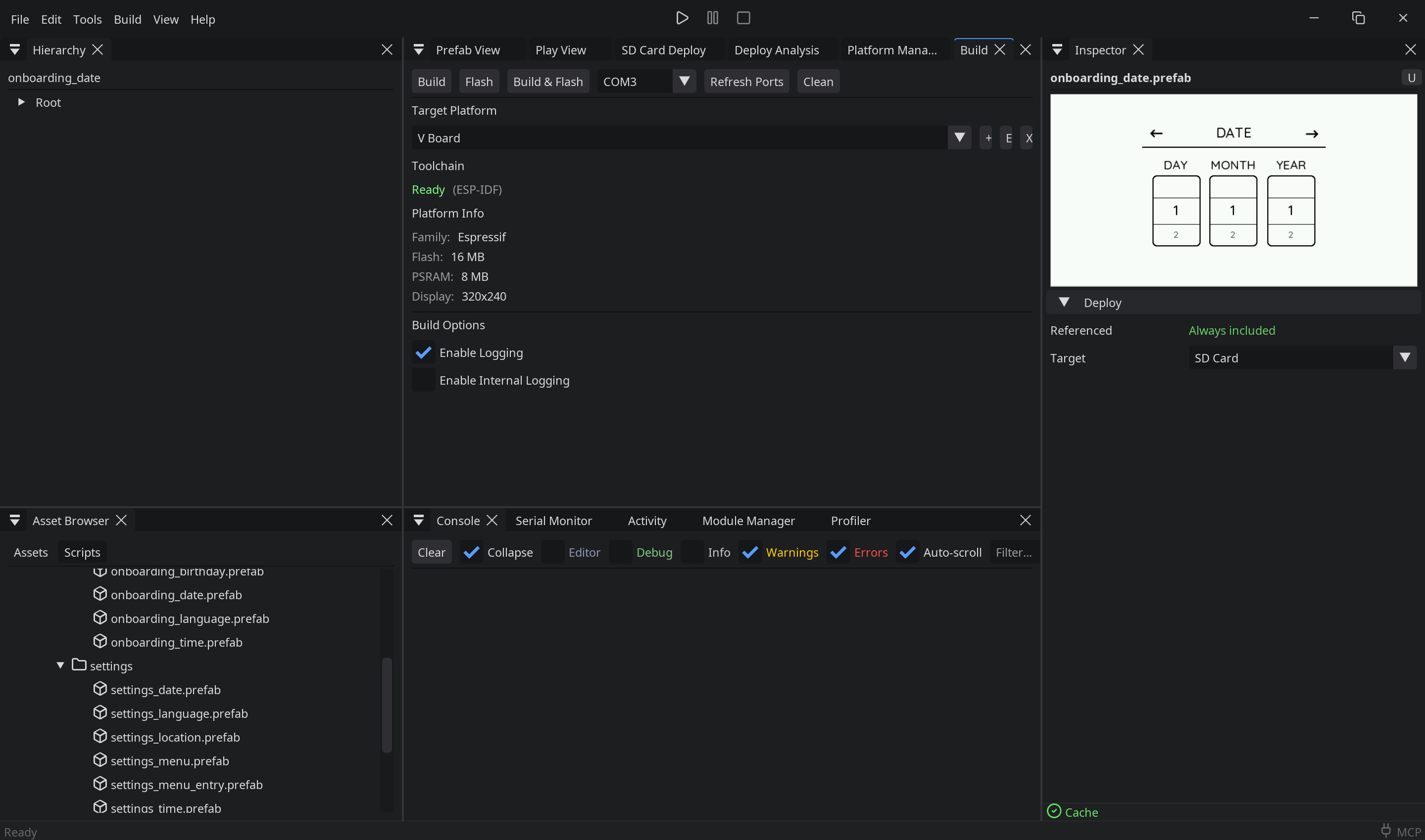

Hi all,
I'm building a 2D engine and a desktop editor for it. It's primarily aimed at games, but the same engine can serve as an LVGL replacement for UI work, or be used for automation. The engine is modular and the platform layer is swappable, so it can target different MCUs. ESP32-S3 is my first stop, which is why I'm posting it here. The modules are public on GitHub under Apache 2.0. The engine core and the editor are not released yet, so the modules on their own don't do much without them just yet. This post is a sneak peek of where it's all going.
The engine
  • C++17, ECS based.
  • Software renderer (RGB565, 888, ARGB8888).
  • Pluggable platform layer covering memory, filesystem, serial, SD, I2C, UART, I2S, display, touch.
  • Pluggable peripheral layer with a driver registry for RTC, GPS, IMU, audio, so you can plug in any chip.
  • Modular. You only compile in what you use. Each module is its own library.
  • Apache 2.0.
The editor
  • Desktop (ImGui, SDL3, OpenGL).
  • Hierarchy, inspector, 2D canvas with gizmos.
  • Asset browser with previews.
  • Undo and redo on everything.
  • Hot reload of code changes without restarting the editor.
  • Play mode: hit play and the prefab runs live inside the editor, so you can iterate without flashing the device every time.
  • Build panel that flashes to the device when you're ready.
  • Prefabs are JSON in the editor and MessagePack at runtime on the device. GUID based asset tables.
  • Built in MCP server, so AI agents (Claude and others that speak Model Context Protocol) can drive the editor for AI assisted development.
Screenshot 2026-05-04 223731.png (306.46 KiB) Viewed 57 times

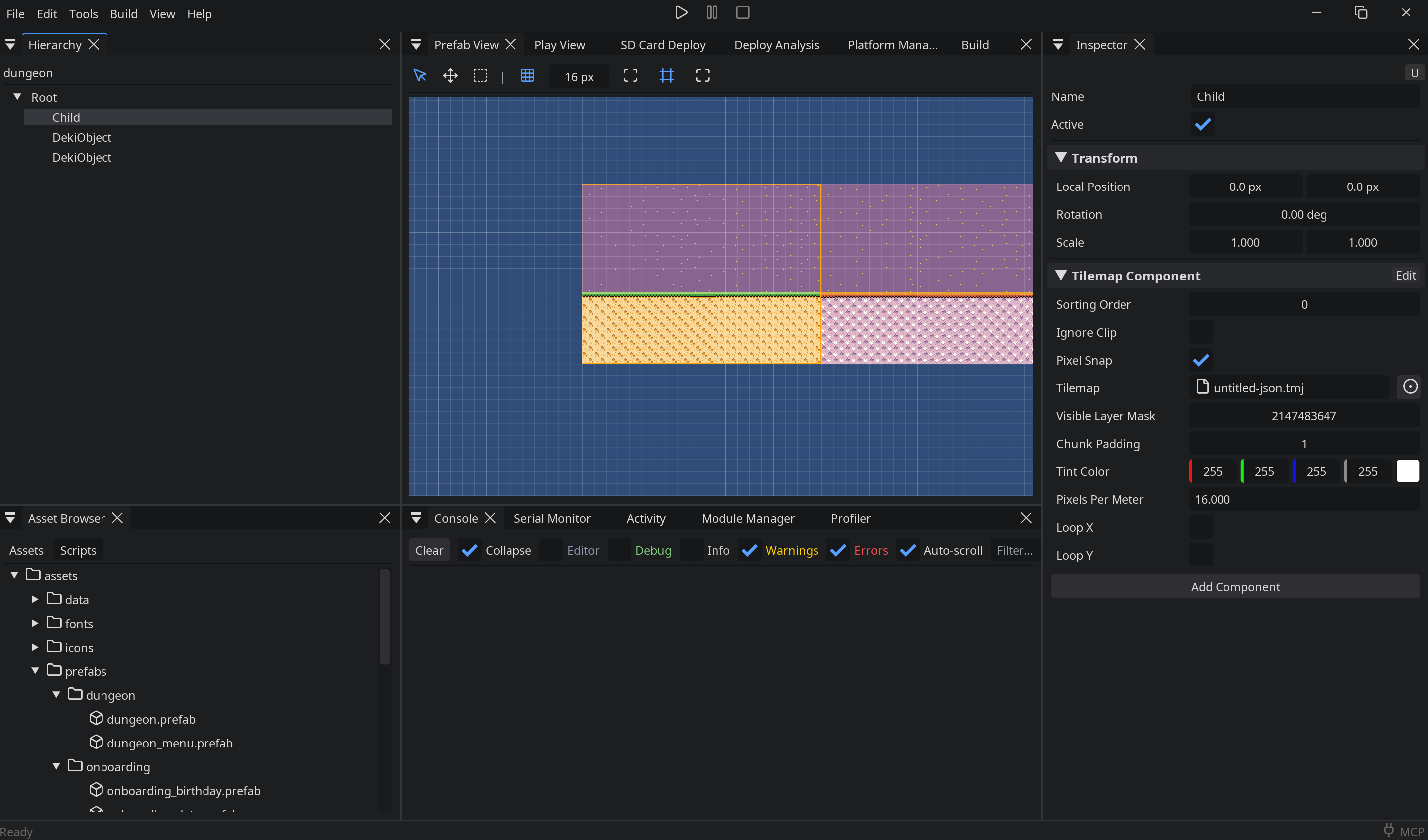

Screenshot 2026-05-04 223839.png (236.29 KiB) Viewed 57 times
