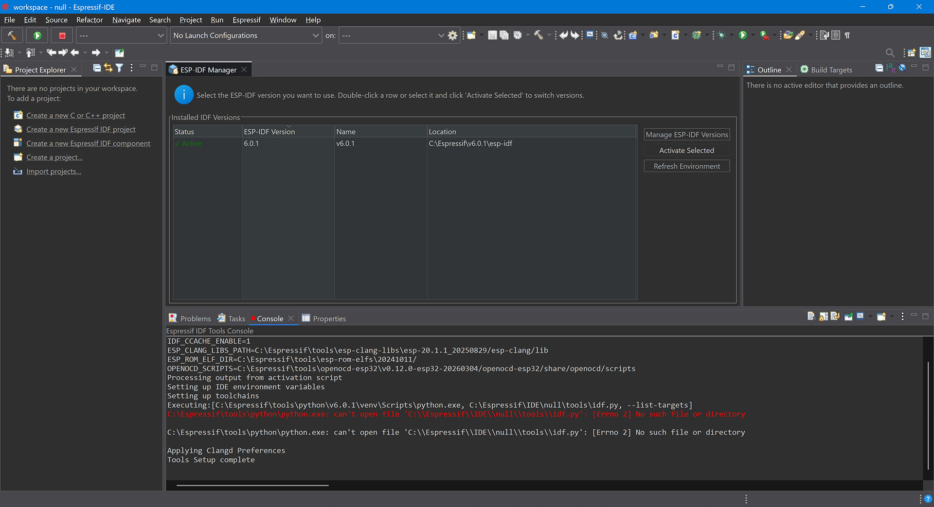

I'm having trouble with the very first steps in a new IDF 6.0:
(1) Clean, fresh and virgin system
(2) Creating c:\Espressif folder to have all the stuff there
(3) Espressif-IDE downloaded and saved to c:\espressif\IDE
(4) Installing EIM -> IDF6.0 -> everything installs & gets fine in c:\Espressif. All the steps are OK, cannot attach screenshots dut to limitation of 3 files!
(5) Launching Espressif-IDE.

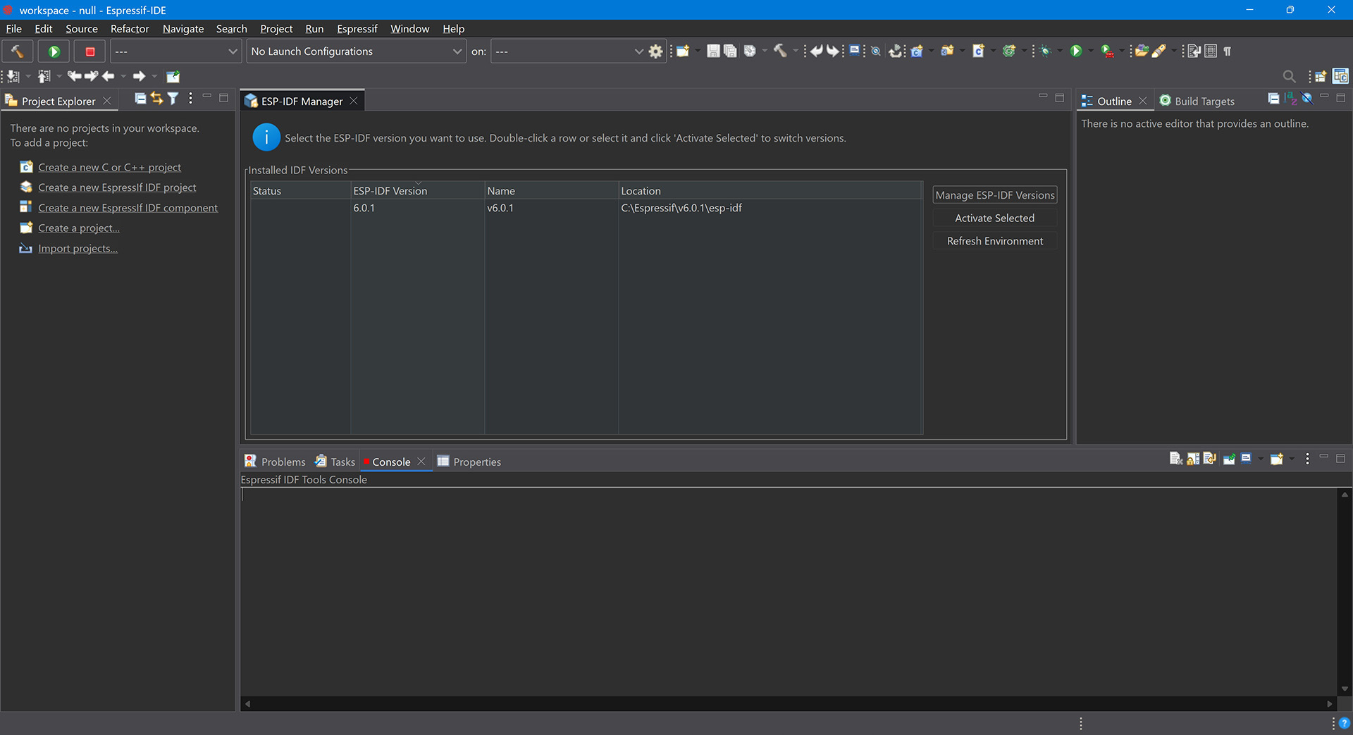

Note the upper-left corner with a faulty title "workspace - null - Espressif-IDE"
(6) Activating the 6.0 IDF and having this wierd error:
Executing:[C:\Espressif\tools\python\v6.0.1\venv\Scripts\python.exe, C:\Espressif\IDE\null\tools\idf.py, --list-targets]
C:\Espressif\tools\python\python.exe: can't open file 'C:\\Espressif\\IDE\\null\\tools\\idf.py': [Errno 2] No such file or directory
Sure there is no NULL folder!
And I cannot track down the bad script that has this bad path speciefied....
With that said I can do absolutely nothing!
Please help me out.

Yes, I got there thru the "Advanced" setup with a single "esp32 chip"... Installation process looks fine but the result is negative (refer to the above).
Looks like the EIM approach is a long way from usable...
