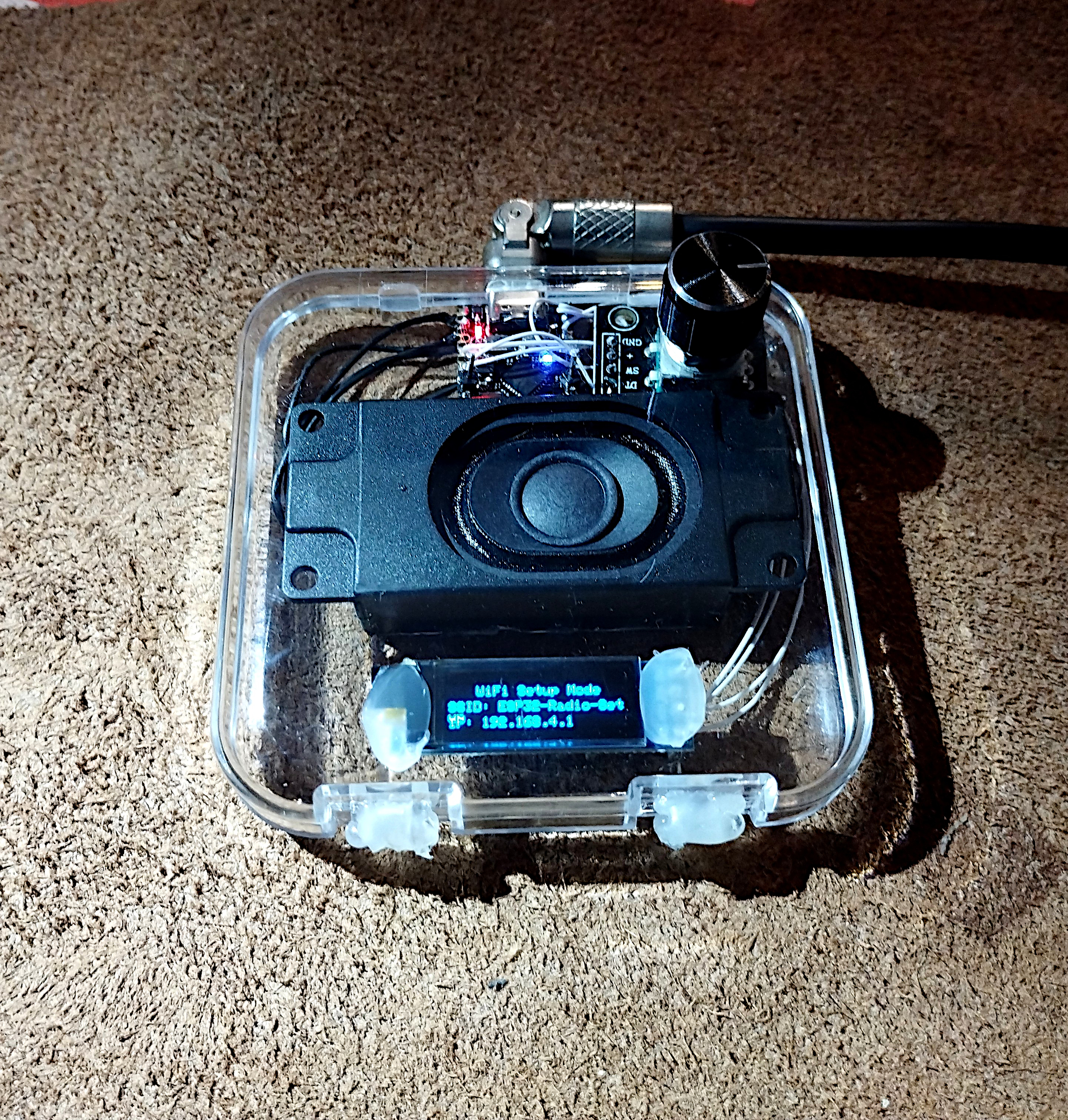

Hello ESP32 Community!
I want to share my latest open-source project built around the ESP32-C3-DevKitM-1 (RISC-V). It is a professional-grade, compact Internet Radio featuring a responsive Web UI, hardware controls, and real-time audio visualization.
The main goal of this project was to achieve smooth audio playback and rich visual feedback using cheap, accessible hardware (~$10 total BOM cost) while maintaining rock-solid system stability.

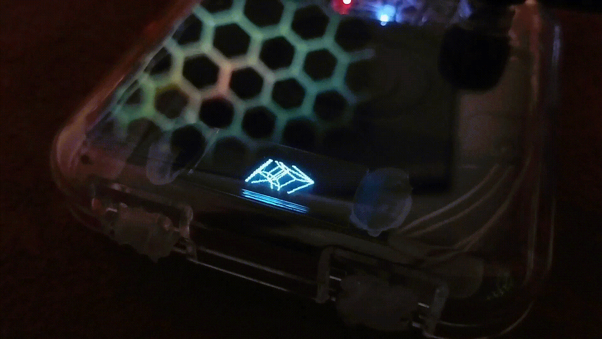

📸 Project Preview
Video/GIF of OLED Visualizers:
🚀 Key Technical Specifications & Features
Audio Processing: High-quality MP3 streaming via HTTP (up to 320 kbps). Powered by a custom FreeRTOS task architecture where the Audio Decoder > Input > Display > WiFi. It utilizes a large 128KB buffer with 2-second prebuffering to ensure zero stuttering even on weak WiFi.
Hardware Setup: * MCU: ESP32-C3 (RISC-V single-core, 160MHz)
DAC/AMP: MAX98357A Class D amplifier connected via digital I2S interface.
Display: 0.91" SSD1306 OLED (128×32) operating via Fast Mode I2C at 400kHz.
Controls: KY-040 Rotary Encoder (utilizing interrupt-driven quadrature decoding and a hardware debounce layer).
9 Real-Time Audio Visualizers: When the radio is idling, the OLED screen switches to a 60 FPS visualizer with 9 selectable styles (Classic Bars, Scrolling Wave, Hexagons, Mirror, Tesseract, etc.) driven by a 16-band audio spectrum analyzer.

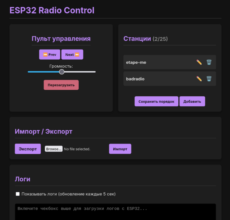

Modern Responsive Web UI: Hosted via ESPAsyncWebServer with a LittleFS-backed filesystem. Includes dynamic station management (drag-and-drop reordering, up to 25 stations, JSON import/export), real-time WiFi diagnostics, system uptime metrics, and a rolling 20KB system log.

🔌 Wiring Diagram Quick Reference
Plaintext
ESP32-C3-DevKitM-1
│ 5V ───> KY-040 VCC & MAX98357A VIN │
│ 3V3 ───> OLED SSD1306 VCC │
│ GND ───> Common Ground │
│ GPIO2, 3, 10 ───> KY-040 Encoder (SW/DT/CLK)
│ GPIO4, 5, 6 ───> MAX98357A I2S (BCLK/LRC/DIN)
│ GPIO8, 9 ───> OLED I2C (SDA/SCL) │
