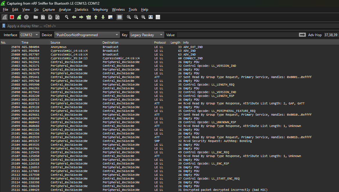

Problem
Whenever the CYBLE central attempts to connect to the ESP32-S3 peripheral, the ESP32 receives the following HCI connection status:
0x1A - Unsupported Remote Feature / Unsupported LMP Feature
The connection is not reported as successful (0x00) on the ESP32 side.
Debugging Performed
To investigate the issue, we captured the connection using the nRF BLE Sniffer.
Our observations indicated that the CYBLE firmware appears to support only legacy BLE procedures and does not appear to negotiate BLE 5.x features.
Based on this, we modified the ESP32 configuration to operate in BLE 4.2 legacy mode.

Questions
What typically causes HCI Connection Status 0x1A (Unsupported Remote Feature / Unsupported LMP Feature) when a CYBLE-222014-01 connects to an ESP32-S3?
Is this status generally caused by:
LE Feature Exchange?
Data Length Extension?
PHY Update?
Connection Parameter negotiation?
Some other unsupported Link Layer procedure?
Could this status later affect:
Pairing/encryption?
GATT service discovery?
Characteristic writes?
Long-term connection stability?
Has anyone successfully connected a CYBLE-222014-01 (or similar PSoC BLE 4.2 Central) with an ESP32-S3 NimBLE Peripheral? If so, are there any additional compatibility settings that should be applied?
Any guidance or suggestions on identifying the root cause of this interoperability issue would be greatly appreciated.
nRF Sniffer Data after applying legacy configuration in ESP32
