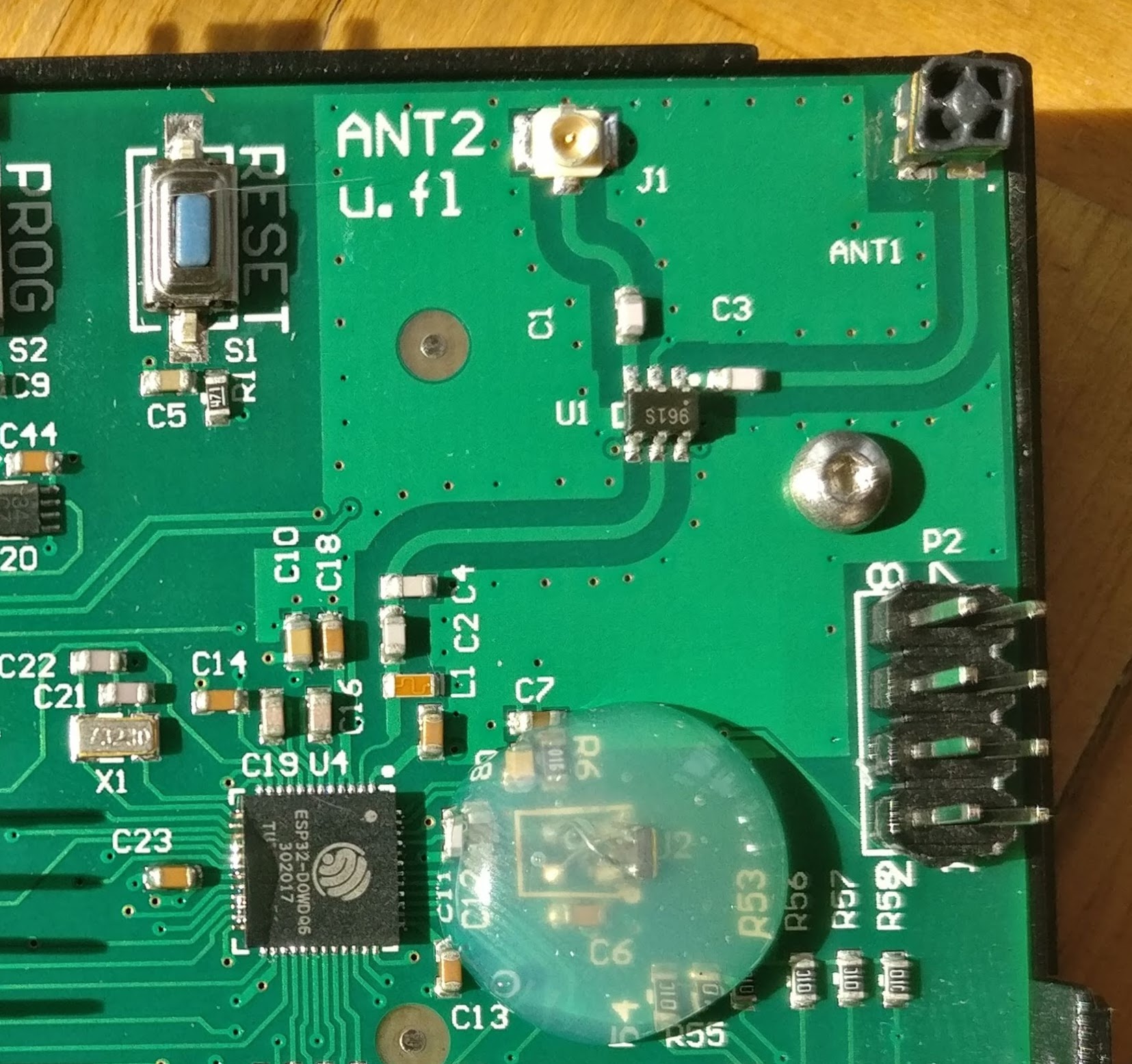

It is difficult to debug a custom RF design without RF test equipment. I don't think there's anything that the ESP32 PHY can do to provide detailed enough information from a purely internal source, although I'll check with my colleagues.
Is the environment around the shielded box likely to be RF noisy? Is the shielded box adequately sealed, grounded, etc against RF?
Is it viable for you try temporarily installing your board in a more normal environment to rule out the shielded box and the very close proximity to the router?
Is it viable for you to try putting an ESP-WROOM module based board (like a dev board) in the same environment as the custom hardware, and compare performance? This will help rule out the hardware design itself.
If you have some photos of the PCB layout, schematics of the hardware, installation, etc. then this may also help.

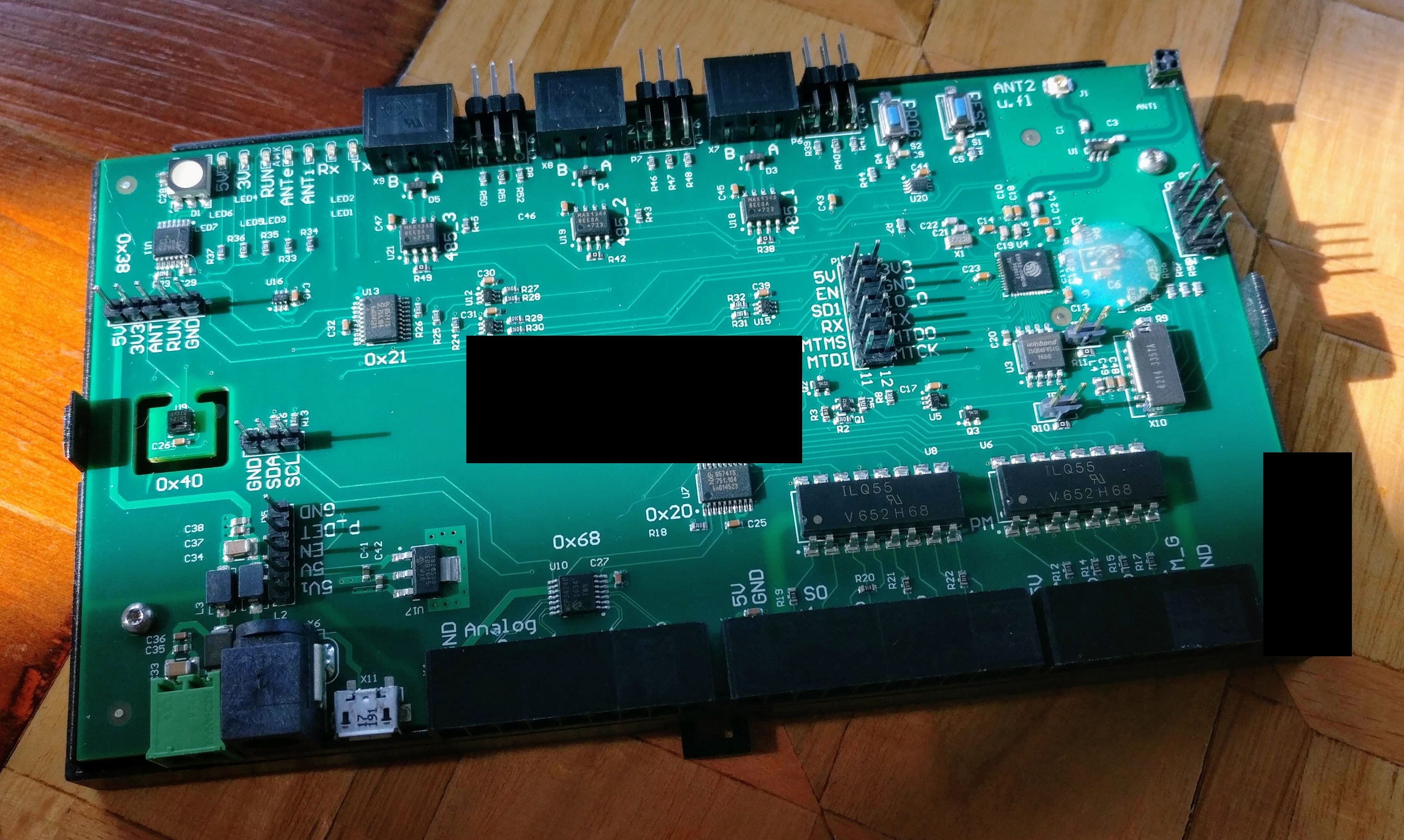

Regarding the installation here is some more infos:
There is no significant RF transmissions going on. The device is placed in a grounded metal distribution box inside a grounded and shielded grid transformer house. We are using multiple devices in similar locations.
Please find pictures of the unit below: we use the default 50 Ohm matching circuit from the datasheet. The device itself is mounted on a DIN-rail and has a plastic enclosure. We added an RF switch to switch between on board Antenna (which we use in this case) and an optional u.FL antenna (not connected here). The chip antenna ( https://www.mouser.de/ProductDetail/Mol ... bO62oZvg== ) works directly with 50 Ohm and is used accordingly to the Molex guidelines. They are also used in many of our boards.

- IMG_20180516_164955.jpg (1.93 MiB) Viewed 19200 times
- IMG_20180516_165027.jpg (409.11 KiB) Viewed 19200 times
Re: Wifi performance poor despite strong (-9) RSSI, how debug/diagnose?
What exactly is happening with that 'crystal under glass'?
It's to protect a bodge correcting swapped pins on the oscillator (40 MHz, 2ppm TCXO).
