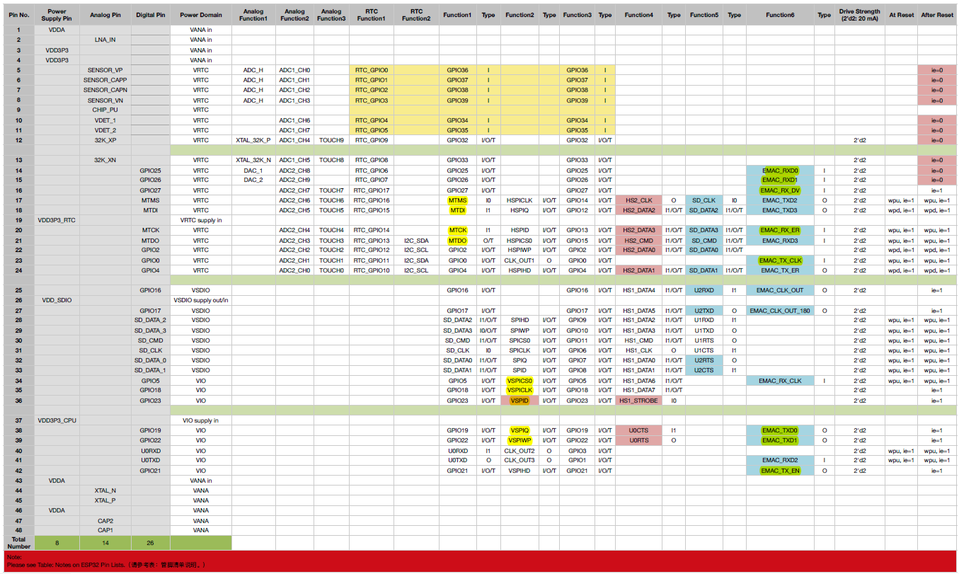

I am going to use ESP32-PICO-D4 in my project with external flash and sRAM. I want to use VSPI in my project for communicating with external flash and sRAM. The SPI pins are already used in ESP32-PICO-D4 for connecting embedded flash and these pins cannot be used. So my question is if i am using VSPI pins and JTAG pins than i will not be able to use Ethernet funcction of ESP32-PICO-D4 in my project ?
In the attachment I have highlighted the pins that are shairing the same functionality..

Seems I'm unable to use JTAG and Ethernet at the same time.
I'm not sure what's going on exactly.
I don't see how the pins are shared because I'm not using GPIO13/MTCK for anything other than JTAG (it is apparently not required for Ethernet RMII, although some documentation lists it as EMAC_RX_ER).
When I start-up with JTAG connected, the emacT task fails to init the PHY chip (LAN8720).
But if I temporarily disconnect JTAG, then emac starts up fine and then I can reconnect JTAG and both works fine.
Currently it's just an annoyance for me, not a show-stopper. But I'd like to know how to fix it.
