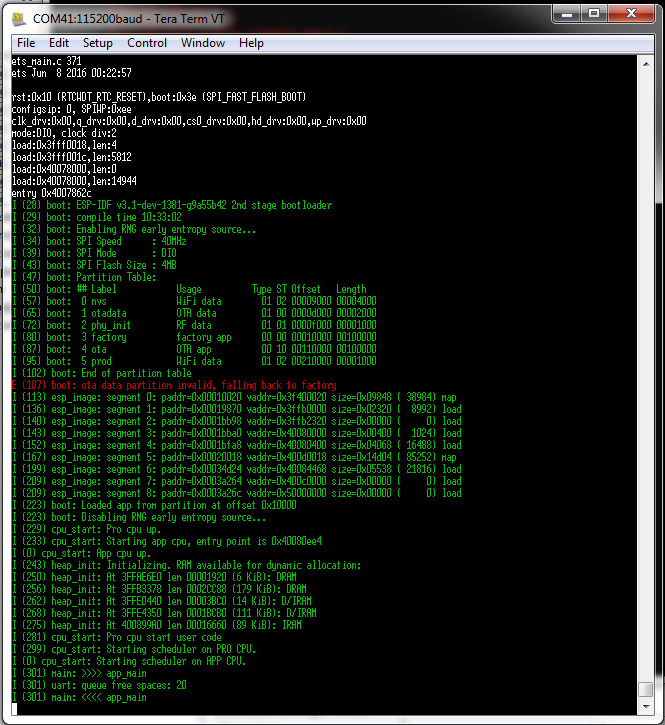

Hello all
I am using the wrover kit and I am using ubuntu 16
I am new to this micro so I think that I missed something
My goal is to write manufacture data to a nvs partition and then read the data
I have used gen_esp32part.py with this file:
# Name,   Type, SubType, Offset,   Size, Flags
# Note: if you change the phy_init or app partition offset, make sure to change the offset in Kconfig.projbuild
nvs,      data, nvs,     0x9000,   16K
otadata,  data, ota,     ,  	    8K
phy_init, data, phy,     0xF000,    4K
factory,  app,  factory, 0x10000,   1M
ota,      app,  ota_0,   ,          1M
prod,     data, nvs,     ,          4K
The prod area will be used to store serial number and product number
I flashed the .bin file with this script:
bin/openocd -s share/openocd/scripts -f interface/ftdi/esp32_devkitj_v1.cfg -f board/esp32-wrover.cfg -c "program_esp32 $1 0x8000 verify exit"
Then I have used nvs_partition_gen.py passing:
key,type,encoding,value
prod,namespace,,
prodotto,data,string,123456789012
scheda,data,string,XYZpy000000
bin/openocd -s share/openocd/scripts -f interface/ftdi/esp32_devkitj_v1.cfg -f board/esp32-wrover.cfg -c "program_esp32 $1 0x210000 verify exit"
The code to read is:

I cannot read the data because nvs_get_str(h, KEY_BSN, p->bsn, &p->len) returns 0x1102
What am I doing wrong?

I thought that the wrover kit was not working properly, but I just discovered that it's my ict, so now I must develop on a linux pc and use com ports on a windows pc.
This is what I get:
I never updated ota, so it is correct to fall back to factory, but it seems that the partition table itself is valid.
Any idea on how to proceed?
