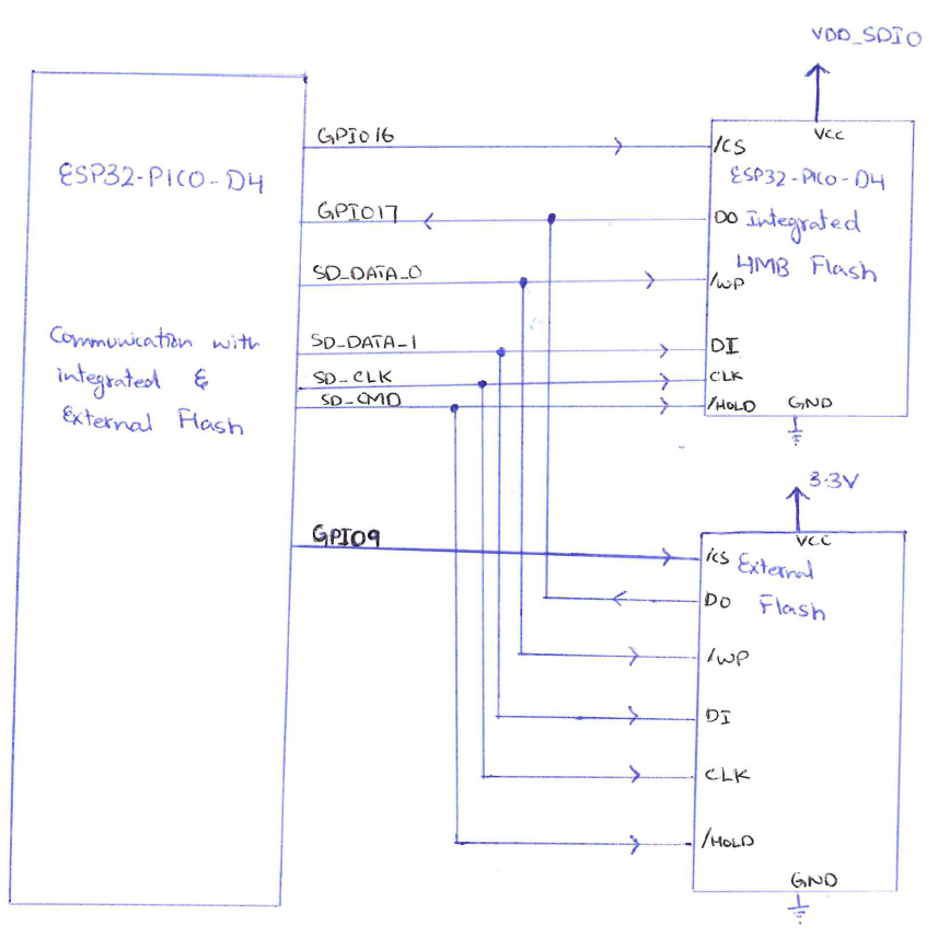

Dear Group Members,
The data sheet of ESP332-PICO-D4 says that "Pins IO16, IO17, CMD, CLK, SD0 and SD1 are used for connecting the embedded flash, and are not recommended for other uses".
If I want to use an external flash with ESP32-PICO-D4 can I use the same pins as of integrated flash of ESP32-PICO-D4 with chip select different as shown in the following attachment ?
Regards:
Habib

hello habibh,
I would like use an external Flash memory to ESP32-Pico-D4, but I'm confused with the connections, please can you help me ?
thank you so much.
