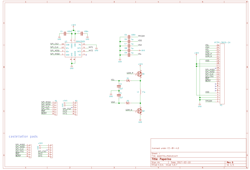

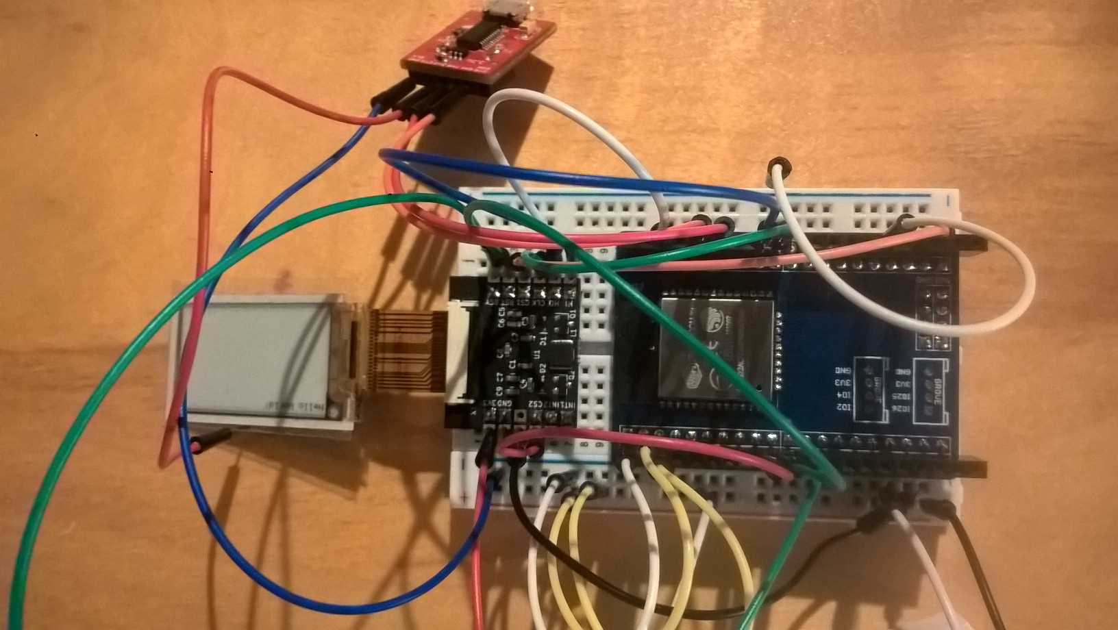

my setup contains a 3.3V powered ESP-WROOM-32 module on a component-free adapterboard, together with a SPI connected ePaper driver board (https://github.com/RobPo/Paperino, see attachment).
When putting the ESP-WROOM-32 alone to deep sleep it consumes about 5µA @3.3V, thats great!
When putting the ePaper driver board alone to deep sleep it consumes about 5µA @3.3V, thats great too!
However, when putting the ePaper driver board to deep sleep, and then afterwards the ESP32; the current appears to increase from 5µA to somewhere around 500µA... as if it is flowing somehow through the SPI GPIOs? Does anyone has an idea how to prevent this?
Thanks in advance.
Robert

- WP_20180625_22_29_19_Pro.jpg (343.4 KiB) Viewed 15335 times

a schematic of how you have things connected would help.

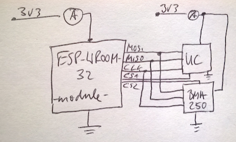

Below a simplified sketch of ESP and the SPI connected ePaper module (consisting of the UC driver IC & BMA250).
There are no external pull-ups connected and the USB2serial Programmer is disconnected.
I tried the following sequence and measured the current flowing into UC+BMA250 step by step (with delays):
Power-On - 500µA
SPI.begin() - 160µA (OK)
UC+BMA250.deepSleep() - 5µm (OK)
SPI.end() - 500µA (NOK)
ESP.deepSleep - 500µA (NOK)
So it seems the that 500µA are always flowing before definition of SPI.begin() and after calling SPI.end().

Re: Deep sleep power consumption with connected SPI device
It's nice that you have this on a breadboard, because it will make it easy to isolate the problem.
The way I would first tackle this is first to bring UC's CSA pin to +3.3v. If no uA change then bring BMA's CLS to +3.3v. IF still no change, then then disconnect the MOSI line, then MISO, then CLK, to see which device or wire is causing the problem. From there you can get a game plane on what could be done.
Another thing you could try in software, is to turn all your GPIO's your using to inputs before going to sleep.
I have not looked to see if there is configurable pull-ups or pull-downs you can enable per pin, but if there is, make sure neither is active, basically HI-Z state.
