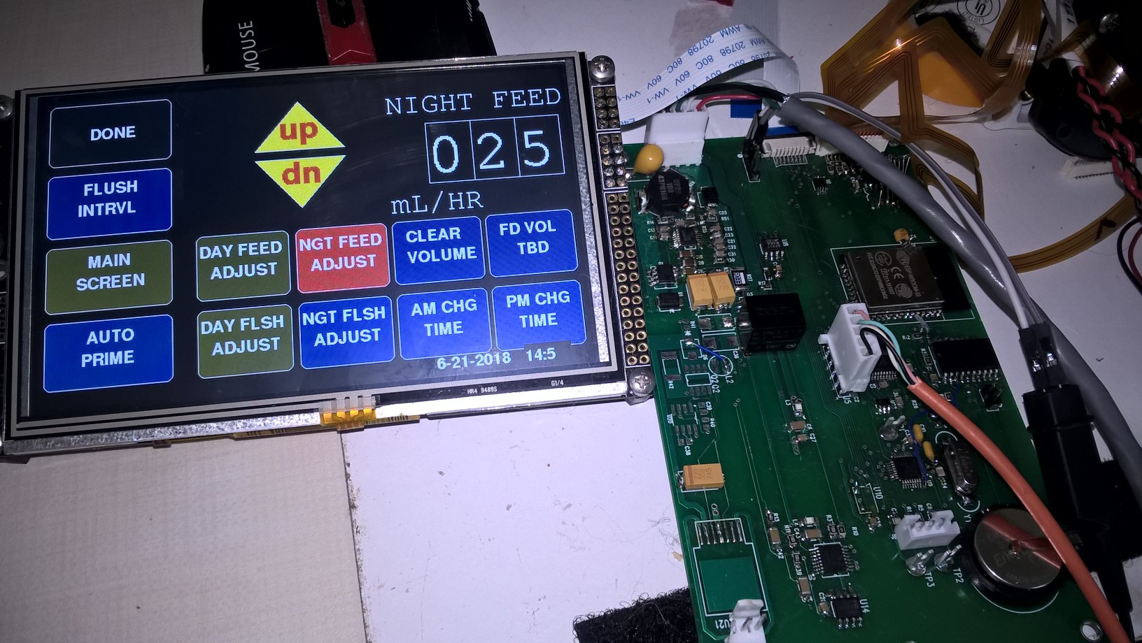

- WP_20180721_10_27_59_Pro.jpg (433.84 KiB) Viewed 15573 times
