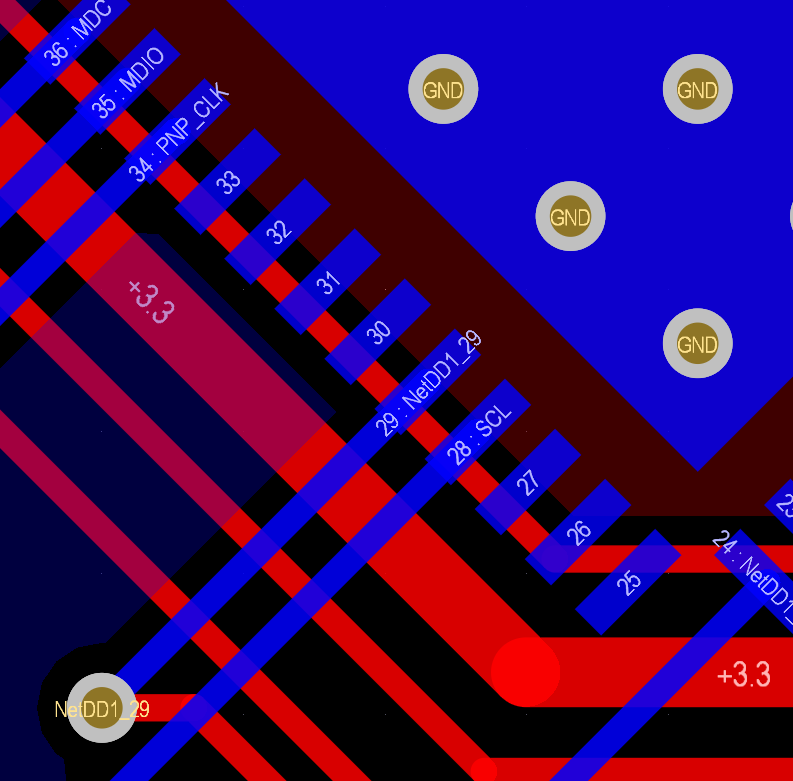

Postby Gordon01 » Mon Aug 06, 2018 4:43 pm
What is also strange: there is no voltage on pin 26.
I have MTDI pulled low by 10k resistor.
Programmer does see ESP32 but can't flash it.
Any ideas what could go wrong?

Do you have anything connected to gpio 6,7,8,11,16,17?

Postby Gordon01 » Tue Aug 07, 2018 5:49 am
No, this pins are not connected

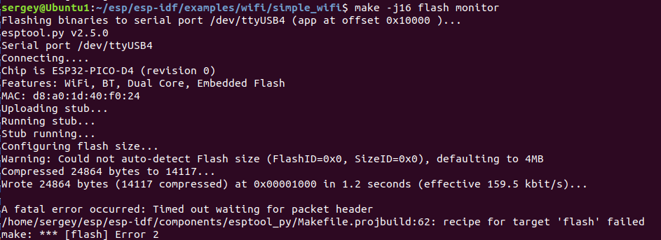

Postby Gordon01 » Tue Aug 07, 2018 6:33 am
sergey@Ubuntu1:~/esp/esp-idf/examples/wifi/simple_wifi$ make -j16 flash monitor
Flashing binaries to serial port /dev/ttyUSB4 (app at offset 0x10000 )...
esptool.py v2.5.0
Serial port /dev/ttyUSB4
Connecting....
Chip is ESP32-PICO-D4 (revision 0)
Features: WiFi, BT, Dual Core, Embedded Flash
MAC: d8:a0:1d:40:f0:24
Uploading stub...
Running stub...
Stub running...
Configuring flash size...
Warning: Could not auto-detect Flash size (FlashID=0x0, SizeID=0x0), defaulting to 4MB
Compressed 24864 bytes to 14117...
Wrote 24864 bytes (14117 compressed) at 0x00001000 in 1.2 seconds (effective 159.5 kbit/s)...
A fatal error occurred: Timed out waiting for packet header
/home/sergey/esp/esp-idf/components/esptool_py/Makefile.projbuild:62: recipe for target 'flash' failed
make: *** [flash] Error 2
