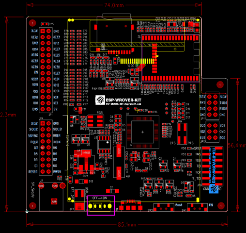

So now that I've gotten JTAG debugging working with the ESP-WROVER-KIT V3, I find myself in need of making a "connection board" to mount the Wrover-kit on (since wires needs to be run from multiple connections on the board [JP1, JP8 JP11]).
I'm thus looking for the physical dimensions of the board, placement of the jumper headers etc. Are these available somewhere, I can only find the schematics for the kit?
Thanks,
Per

ESP_igrr
Posts: 2076
Re: ESP-WROVER-KIT V3 physical dimensions
Postby ESP_igrr » Mon Aug 13, 2018 8:54 pm
Hi permal, one drawing i was able to find does have outer dimensions, but unfortunately doesn't have dimensions between headers.

Postby permal » Mon Aug 13, 2018 9:09 pm
Thanks Iggr. I might be able to get the distances for the headers based on that image, but could you please ask your hardware people if they can provide the actual distances as that'd be 100% accurate?

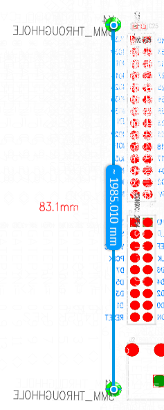

ESP_igrr
Posts: 2076
Postby ESP_igrr » Thu Aug 16, 2018 7:22 am
Attached is the DXF drawing, is that okay?
ESP-WROVER-KIT_20180816B.zip

Postby permal » Thu Aug 16, 2018 8:14 am
Yes, I think I can import that into Fusion 360 and get the measurements from there. Otherwise I think there's a free viewer from Autodesk.

Postby permal » Sat Sep 08, 2018 8:55 pm
I've been trying to extract the dimensions, but the measurement tool in Autodesk Viewer is giving me completely insane values, as can be seen in the attached image. Is the DFX exported at some scale?
