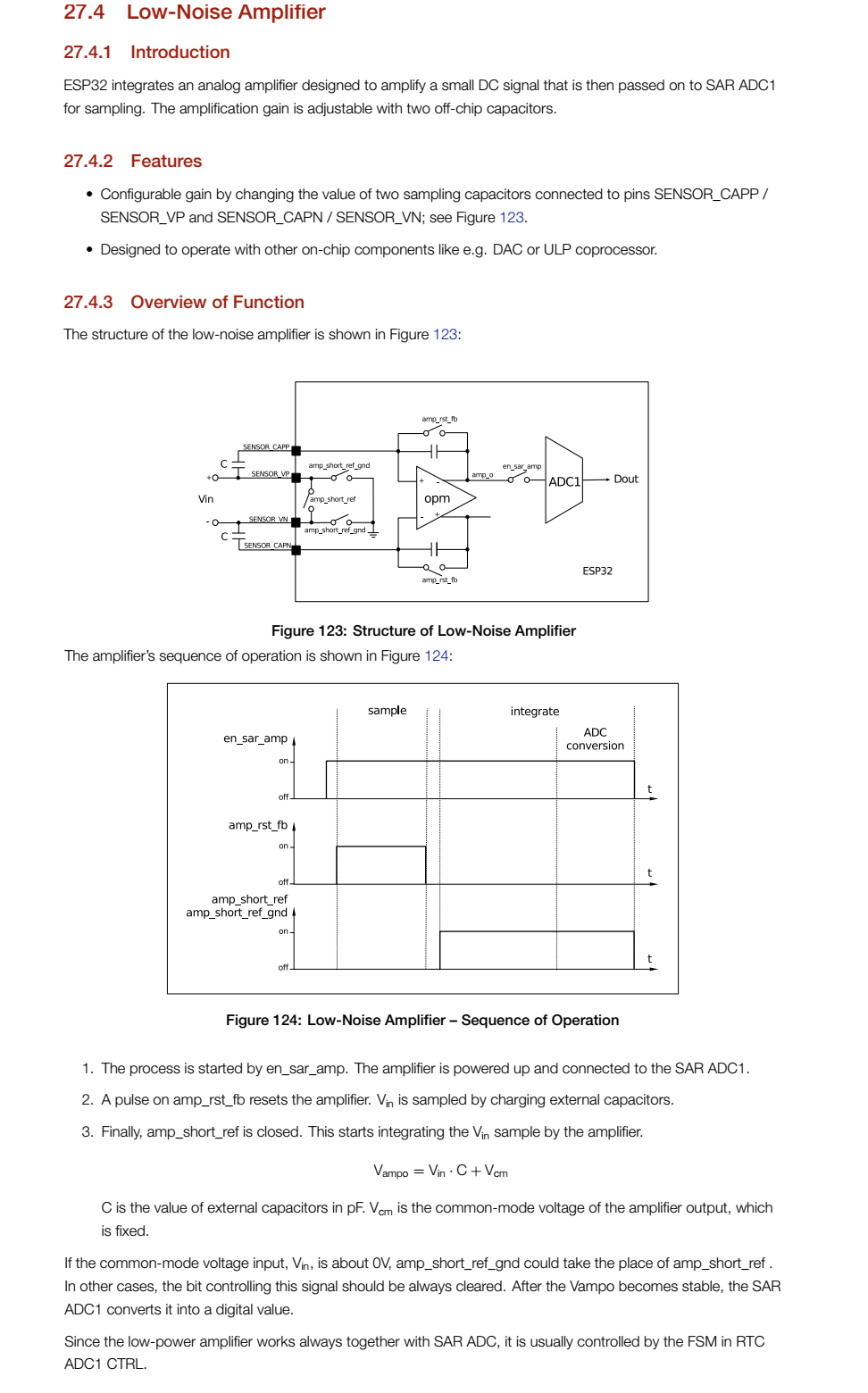

in the data sheet its written
''The output of the power amplifier is also adjustable''
how can i do this ? where can i find the option for it ?
i also want to measure the power consumption of Power amplifier/operational amplifier in ESP32

Hello Ahmed, designing with esp-idf you can call "make menuconfig" and set the PA output power, check line 1064 of https://github.com/espressif/esp-idf/bl ... 32/Kconfig
Actually this mentioned section it's not for the OPamp, rather the wifi.
I just noticed that the OPamp description is removed from the latest Technical Reference Manual, dunno why.
Here you can see a short description and a way to set the gain.
If you know OPamps in general, this is an integrator configuration of the opamp.
https://en.wikipedia.org/wiki/Op_amp_integrator
Anyway I attached here the snippets from the old TRM.
On the WROOM and WROVER modules there are two 270pF caps already placed, which are to set the gain (seen in the attached sheet how). So you can only adjust it if you replace those components.

The opamp to ADC is starting to make sense to me. But I still have a gap between what I have and how to make it work. Do you know if there is there any sample code available?

Honestly, I would not use the OPamp in the ESP, rather an external one, or a PIC with a built-in OPamp, which will do the conversion and use either SPI or I2C with the ESP to do the data sharing.
