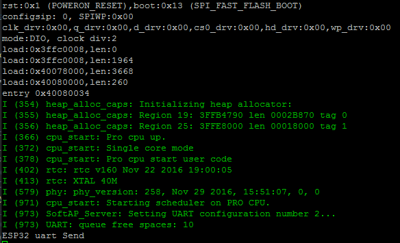

uart 2 does not work !!!
I am very urgent.
The code is written as follows:
  uart_port_t uart_num = UART_NUM_2;                                     //uart port number
  uart_config_t uart_config = {
      .baud_rate = 115200,                    //baudrate
      .data_bits = UART_DATA_8_BITS,          //data bit mode
      .parity = UART_PARITY_DISABLE,          //parity mode
      .stop_bits = UART_STOP_BITS_1,          //stop bit mode
      .flow_ctrl = UART_HW_FLOWCTRL_DISABLE,  //hardware flow control(cts/rts)
      .rx_flow_ctrl_thresh = 122,             //flow control threshold
  ESP_LOGI(TAG, "Setting UART configuration number %d...", uart_num);
  ESP_ERROR_CHECK( uart_param_config(uart_num, &uart_config));
  QueueHandle_t uart_queue;
  ESP_ERROR_CHECK( uart_set_pin(uart_num, UART_PIN_NO_CHANGE, UART_PIN_NO_CHANGE, UART_PIN_NO_CHANGE, UART_PIN_NO_CHANGE));
  ESP_ERROR_CHECK( uart_driver_install(uart_num, 1024 * 2, 1024 * 2, 10, UART_INTR_NUM, &uart_queue));
  char* test_str = "This is a test string.\n";
  uart_tx_chars(uart_num, (const char*)test_str,strlen(test_str));
  printf("ESP32 uart Send\n");
  while(1);
The result screen is as follows.
However, it does not work.
I have measured it with an oscilloscope, but there is no signal.
I hope you solve it.

You need to specify some real pin number instead of UART_PIN_NO_CHANGE at least for the TXD pin. It will help if the pin you set is the same pin which you are probing with the scope.

I have same issue, but I am not using default pins. In scope, there is no TX signal.
#define RS485_TX            34
#define RS485_RX            22
#define RS485_DE            19
#define RS485UART           UART_NUM_2
        .baud_rate = 9600,
     // RS485 configuration
    uart_param_config(RS485UART, &uart_config);
    // RS485 pins
    uart_set_pin(RS485UART, RS485_TX, RS485_RX, UART_PIN_NO_CHANGE, UART_PIN_NO_CHANGE);
    ESP_ERROR_CHECK(uart_driver_install(RS485UART, 128 * 2, 128 * 2, 0,
                                        NULL, 0));

34 is input only, you can use for rx but not tx

OMG, I cannot believe I missed this!
