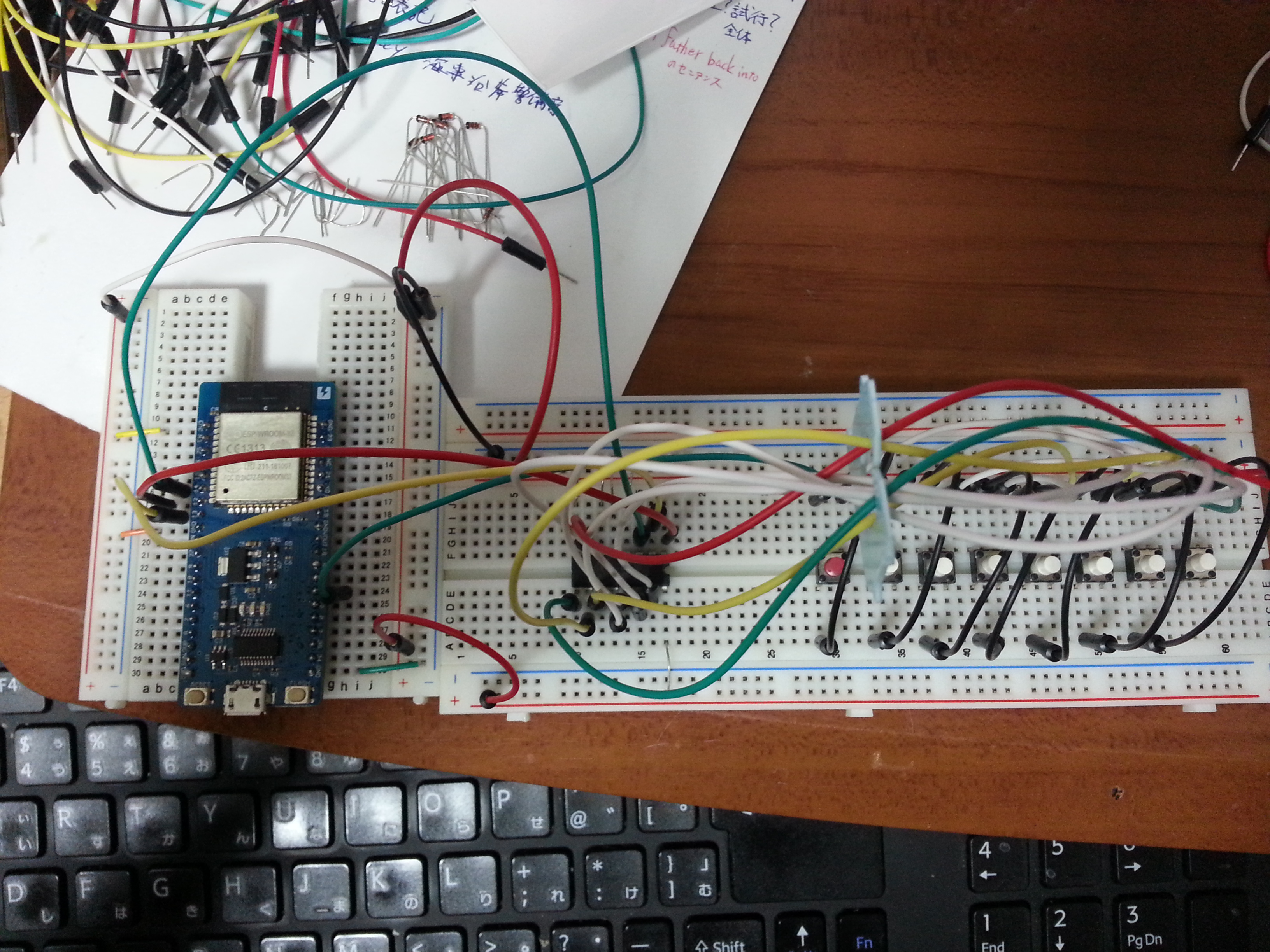

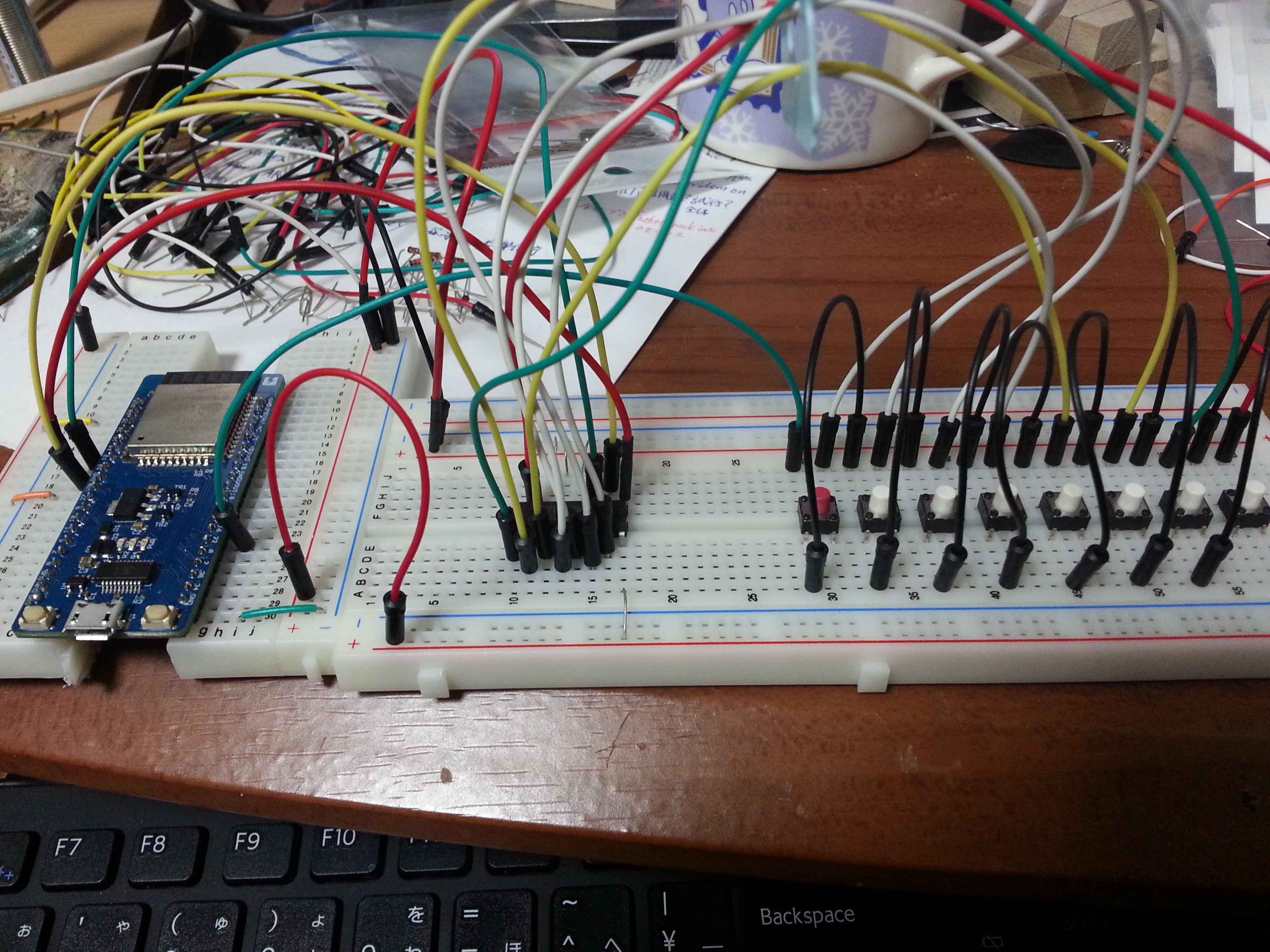

I'm trying to build key matrix circuit by ESP32 and 74HC138, but it doesn't work.
The circuit is below.
When I push one of the switches, I want to get their own number(0~7).
This circuit has two problems.
1. Even if I properly connected 74HC138 with the switches, I pushed #0, #4 and #6 switch and I got wrong number(4, 6 and 0).
2. When I pushed #3 switch, I got 1 and 3 one after the other.
When I pushed #0 switch, I got 4. ←wrong
When I pushed #1 switch, I got 1. ←right
When I pushed #2 switch, I got 2. ←right
When I pushed #3 switch, I got 1 or 3. ←wrong
When I pushed #4 switch, I got 6. ←right
When I pushed #5 switch, I got 5. ←wrong
When I pushed #6 switch, I got 0. ←wrong
When I pushed #7 switch, I got 7. ←right
Note that I properly connected 74HC138 with the switches and I could build key matrix circuit by Arduino UNO 3 in the same way.
My code is below.

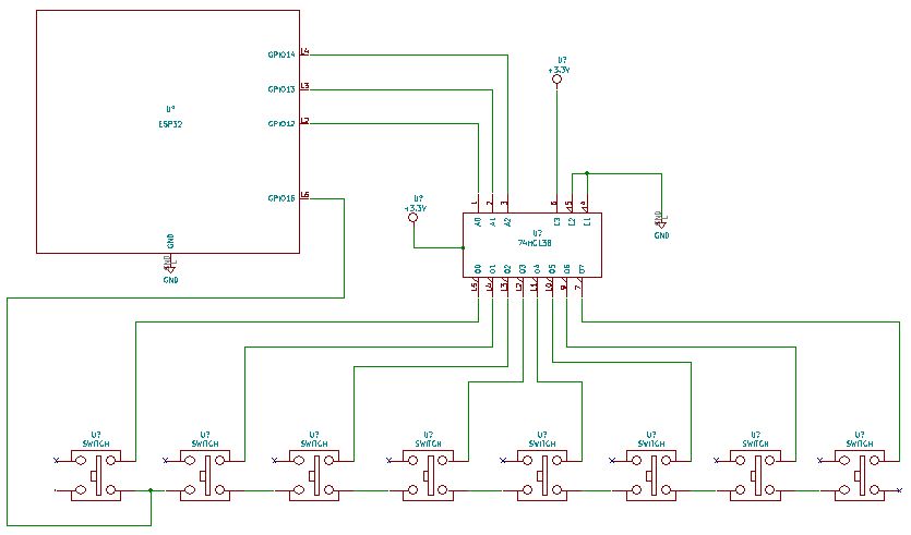

Hello, Tom Meyers.
Thanks for taking the time to reply.
It took a long time to edit schematic. But I managed to do it.
Here is my schematic.
My key matrix circuit doesn't work yet.
So, please tell me if you know something about this.
Yosuke

Posts: 10617
Re: ESP32 with a tons of switch
Postby Sprite » Wed Oct 10, 2018 2:13 am
I disagree, what Yosuke is doing should work perfectly well.
First of all, the use of an '138 here is unconventional, but should work perfectly fine, given that only one button is pressed at the same time. The ESP32 uses the '138 to make each output low sequentially. Note that Yosuke has turned on the pull-up on GPIO16 in software. This means that when a button is pressed and the line for the button is not selected *or* no button is pressed, GPIO16 is high. Only when the line for the button is selected *and* the button is pressed, the line goes low. When software detects this, it knows which line it has selected, and as such knows which button is pressed.
(Yosuke: you may still want to modify your schematic a little bit. If you press two buttons at the same time, you're essentially shorting your selected low output with an unselected, high output at times. This is Not Good in general. You could work around this by e.g. connecting 1K resistors between the buttons and the '138; that's enough to limit the current, but will still easily over-power the internal pull-up, which is 50K or so. Even better: use diodes instead of resistors so current can only run from the buttons into the '138; that way your setup can actually detect all the buttons pressed as well.)
For the subject of bounce... well, it's not really an issue here. Bounce is only an issue if you have edge-triggered logic, with either a direct connection or a scan rate faster than the bounce time of the buttons (say, 100ms). Both are not true here; the reads happen with an 100ms delay, which is enough time for a button to finish bouncing, and the output is a simple print of the state; nothing that triggers on an edge.
Yosuke: I'm not quite sure why you get the results you do... the only thing that springs to mind immediately is that your breadboard setup has a fairly big parasitic capacitance, and the pull-up in GPIO16 may not be enough to overpower it. You can try adding an external resistor (anywhere between 1K and 10K should work) from that pin to 3.3V. If that doesn't work: if you have an oscilloscope or logic analyzer, it may be helpful to visualize the signals and see what's happening.
