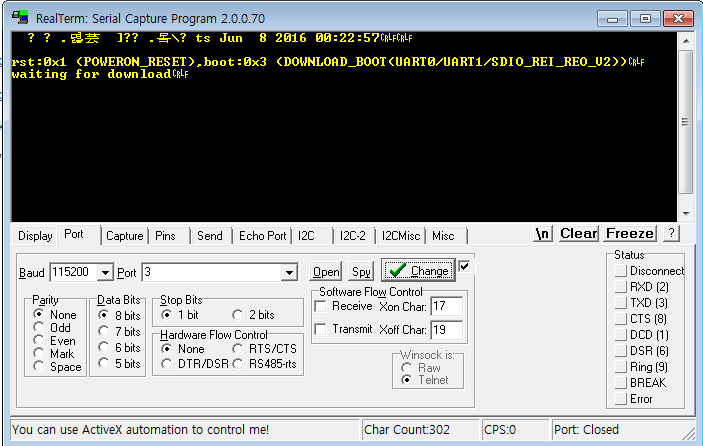

After putting the device into "download mode" using Realterm --> port closed --> set as /COM3 & baud rate 115200 in menuconfig --> make flash, I get the following error:

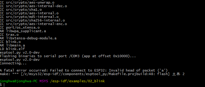

esptool.py v2.0-dev
Flashing binaries to serial port /COM3 (app at offset 0x10000)...
esptool.py v2.0-dev
Connecting...
A fatal error occurred: Failed to connect to ESP32: Invalid head of packet ('a')
make: *** [/c/msys32/esp-idf//components/esptool_py/Makefile.projbuild:48: flash] Error 2

Try:
bring the board in bootload-mode(hold the flash button down) till the download starts.. ;)

It worked. Thank you!

Glad you got this working. It's a hardware bug (with Windows & some dev boards), that we are hoping to fix in the next hardware revision.
In the meantime, I've asked the documentation team to revise the Getting Started Guide to mention this workaround.
