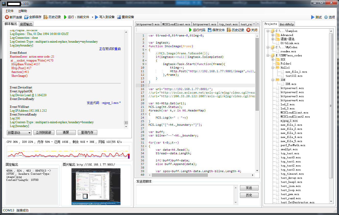

Hi everyone,
I am making a script solution to implement my ideas into chip easier.
Key features:
1 - Good IDE
Usb connect and play, Click and run script in 1 second , Save as startup script without PC connected.
CPU/Memory/Network status monitoring, Log output , Fixed position Text/Image output.
2 - Powerful scripting language
C-Style , weak/strong type , closure , class/function/delegate , class inside function , function inside class
virtual/override OOP , property getter/setter, JSON , Binary serialization
try/catch/finally , exception stacktrace and line number ,
Eval script string, Asynchronize programming, Multi-Task programming , foreach keyword for list/dict
Work with custom c++ code, pre-compile into C++ code for obfuscation and better performance .
Object destruction callback , Object attached dictionary , .... etc ....
3 - Memory (WROOM):
Spend 55K memory when startup, and 260K free for play ideas.
Spend 38K for WIFI+LWIP , 220K free for client/server.
Spend 30-40K for Http library , 180K free for fast Http client/server scripting
4 - IO:
GPIO/PWM/SPI , tested 320x240 TFT as 16 FPS , need more time for others
5 - Network Performance
Big Buffer: WROOM 900KB/s , WROVER 1.5MB/s
(Depend on the buffer setting in menuconfig)
Small Buffer: about 18 socket connection + 330 http keep-alive requests per second .
Tested 12 connections in WROOM
Now It works and stable, just still need 3-4 months to finish more libraries.
Will be available at 2019

100 lines code to show MJpeg stream into TFT monitor
var eachrow=24;
var spi=Spi.Master("hspi",80,320*2*eachrow, 14 , 13 , 12 , 15 , 21 );
var rst=Gpio.Out(18);
rst.SetLevel(0);
delay(100);
rst.SetLevel(1);
delay(100);
var ili_init_cmds=[[207,[0,131,48],3],[237,[100,3,18,129],4],[232,[133,1,121],3],[203,[57,44,0,52,2],5],[247,[32],1],[234,[0,0],2],[192,[38],1],[193,[17],1],[197,[53,62],2],[199,[190],1],[54,[40],1],[58,[85],1],[177,[0,27],2],[242,[8],1],[38,[1],1],[224,[31,26,24,10,15,6,69,135,50,10,7,2,7,5,0],15],[225,[0,37,39,5,16,9,58,120,77,5,24,13,56,58,31],15],[42,[0,0,0,239],4],[43,[0,0,1,63],4],[44,[0],0],[183,[7],1],[182,[10,130,39,0],4],[17,[0],128],[41,[0],128]];
foreach(var item in ili_init_cmds)
    var buff=Buffer.Create(16,"DMA");
    foreach(var b in item[1])buff.WriteByte(b);
    spi.SendByte(item[0]);
    spi.SendBuffer(buff,1);
    if(item[2]>=128)delay(100);
function makebuff(v1,v2)
    Buffer b=Buffer.Create(4);
    b.WriteByte(v1>>8);
    b.WriteByte(v1&255);
    b.WriteByte(v2>>8);
    b.WriteByte(v2&255);
    return b;
function ShowJpegToLCD(jpegbuff)
    Buffer bmpbuff=__jpegdecode(jpegbuff);
    for(var i=0;i<240;i+=eachrow)
        spi.SendByte(42);//x
        spi.SendBuffer(makebuff(0,320),1);
        spi.SendByte(43);//y
        spi.SendBuffer(makebuff(i,eachrow+i),1);
        spi.SendByte(44);//write
        spi.SendBuffer(bmpbuff.Subbuf(i*320*2,320*2*eachrow),1);
var url="http://192.168.1.77:8081/";
var ht=Http.Get(url);
MCS.Log("connected.")
var buff;
var bline="--"+ht._boundary;
for(var t=0;;t++)
    var data=ht.Read();
	if(!buff)buff=data;
	else buff.Append(data);
	var spos=buff.Length-data.Length-bline.Length-4;
	var pos=buff.ToString().IndexOf(bline,spos>0?spos:0);
	if(pos==-1)
		continue;
	if(pos>0)//not first
		var crlfpos=buff.IndexOfDoubleCrlf();
		if(crlfpos!=-1&&crlfpos<pos)
			var headers=buff.Subbuf(0,crlfpos);
			var frame=buff.Subbuf(crlfpos+4,pos-crlfpos-4-2);//remove \r\n before next boundary
			ShowJpegToLCD(frame);
	var delsize=pos+bline.Length+2;
	if(buff.Length>=delsize)
	    buff.SelfRemoveLeft(delsize);
	else
	    ht.Read(delsize-buff.Length);
	    buff=null;

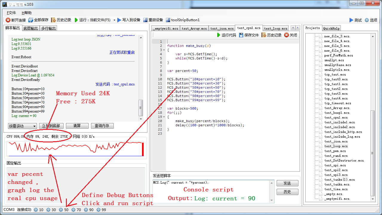

Demo of the IDE Button idea
Recent update : optimized memory usage.
Now it support 16 active TCP concurrent connections and read or write small pieces 1000+ times per second.
The IDE helps to monitor the status of the chip
It's very helpful for the prototype of a product , or just test the pin-connection ,
Or a good peer debugger when connect another chip with UART/SPI/I2C/UDP/TCP etc .

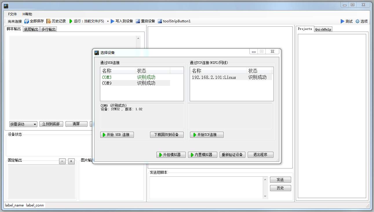

Now support
ESP32
STM32
RaspberryPI
Windows C++ Emulator
.Net C++ CLI Emulator
