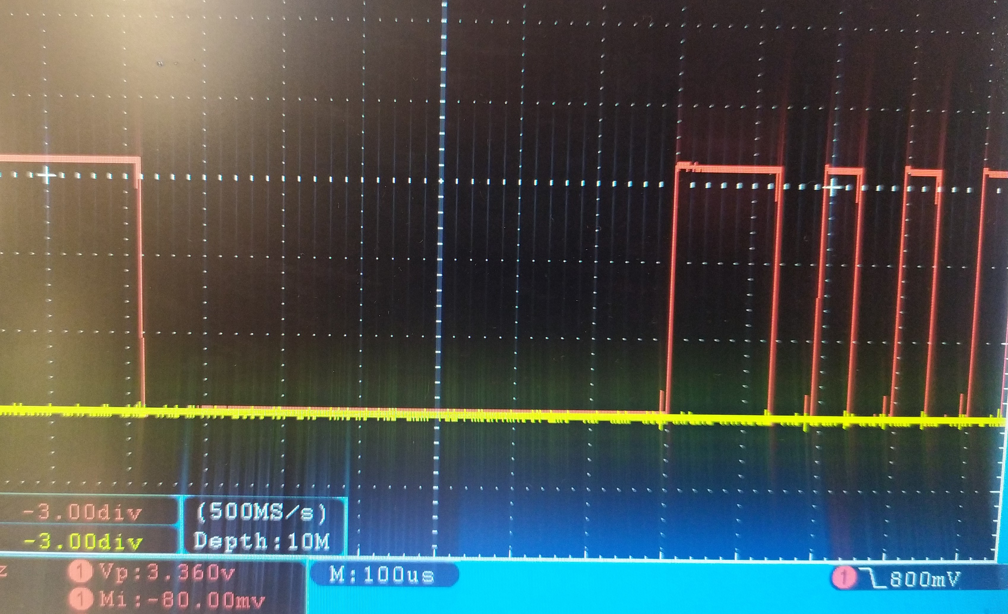

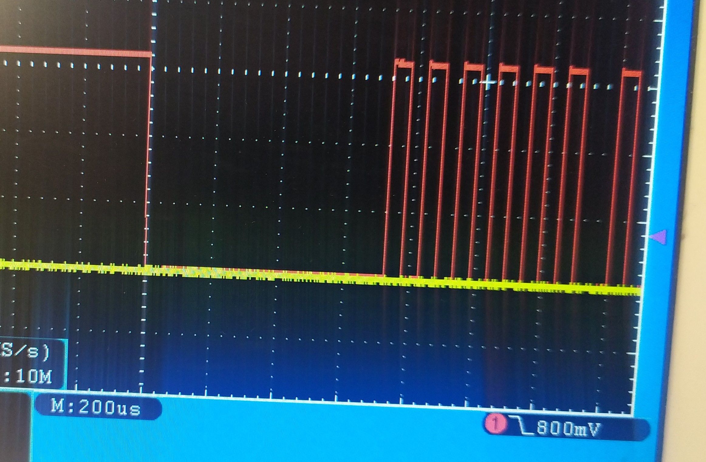

Hi There,
I got the same problem and I like the solution by phatpaul much more. Only issue is that it does not work for me...
I made two pictures one with a good break and one with the solution by phatpaul. be aware that I used accidentally 200us and 100us in the pictures. So the solution by phatpaul is optically more streched.
I played arround with the LIN_BREAK_BAUDRATE, but it did not help.
I assume that the long high level after the break is the problem. How do I get rid of it?

Re: UART break at first
Florian,
How did you determine that it doesn't work? Also, how do you know that it is the space after the break which is the problem?
Are you using it for LIN bus? My understanding is that LINbus spec allows for "inter-byte space", see Fig 2.3 in https://www.lin-cia.org/fileadmin/micro ... N_2.2A.pdf (But I can't find the max value in the spec, it only says it should be "non-negative".)
Or do you have an application where that timing is required? If so, then it may be difficult to achieve at this high level API. You would need to write your own low-level driver using interrupts.
