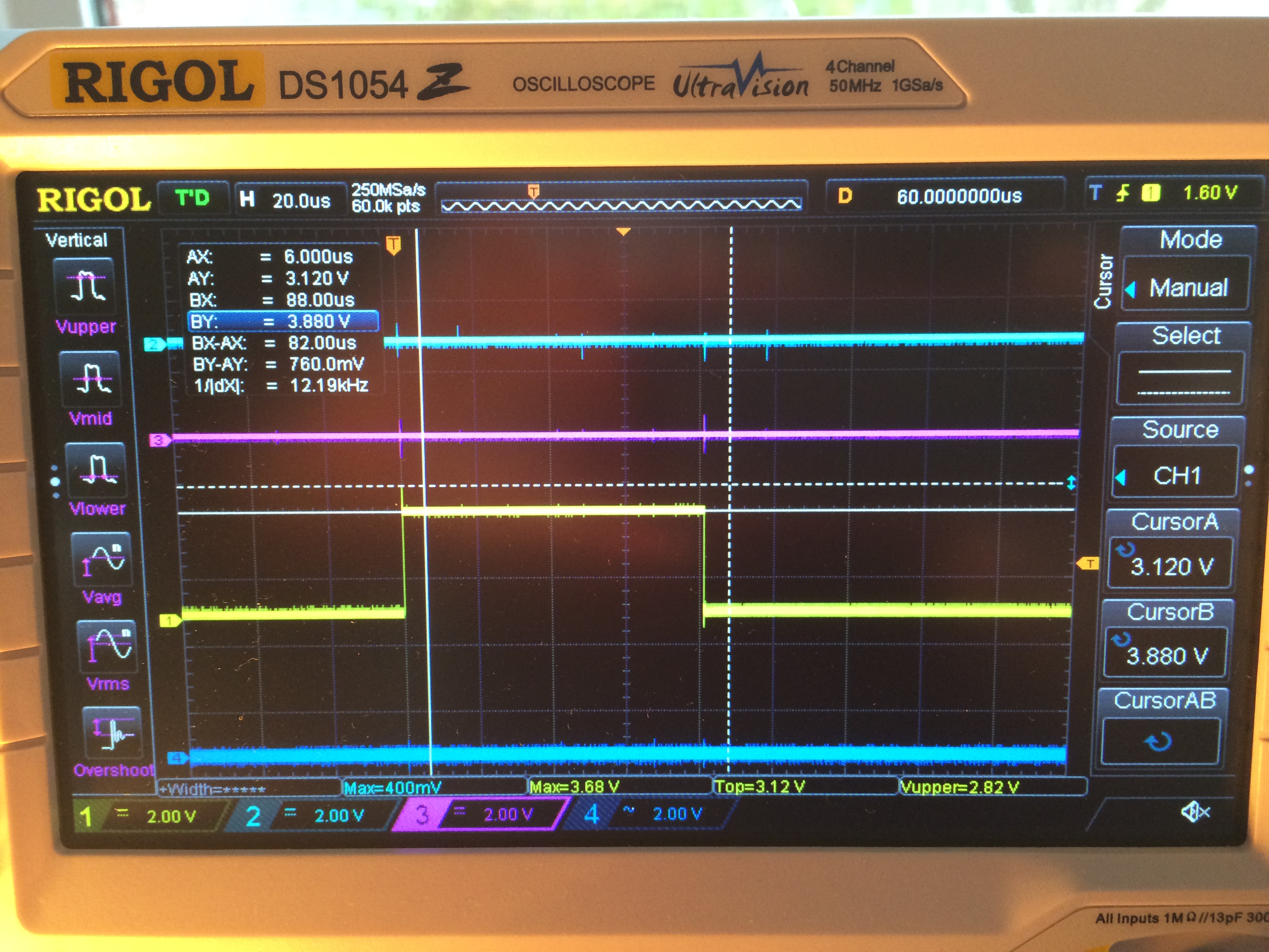

I implemented this using the zero-crossing interrupt and it works, most of the time. I'm using zero crossing interrupt (based on external GPIO input from zero-crossing detection circuit) instead of suggested timer reset interrupt because I need to reset the LEDC timer at the zero crossing point anyway.
Here's a video of it working. Oscilloscope traces are as follows, from top:
* Cyan: Zero Crossing Output from dimmer hardware (trigger).
* Purple: interrupt duration as measured via LED GPIO 5 output. Typically < 10us pulse width.
* Yellow: Channel 0 PWM output.
* Blue: Channel 2 PWM output.
A lot of the time, it works great, very steady fades.
Very randomly, however, I'll see periods where it seems like the LEDC hardware isn't responding to my requests to update the hpoint value. The PWM output continues, and in correct phase with 60hz AC (so timer resets are happening), and the interrupt seems to continue running (based on purple oscilloscope trace), but the relative PWM phase doesn't change with updates to the hpoint register. This will continue for a number of seconds and then it will be fine for a while. Here's an example of this on video.

* adding nops or memw instructions around the register updates.
It seems like this may happen more when the hardware (Sparkfun ESP 32 "Thing") is warmed up. It gets hot enough to be painful to the touch. I may experiment with a small heat sink.
Any hints for trying to debug this?

Fyi, the ESP32 isn't supposed to get hot enough to be painful, and I've never seen that happen. Are you sure all voltages you feed into it are in range, and no weird currents are running anywhere? Do you have a schematic of the thing somewhere?

Sparkfun ESP 32 Thing Schematic is here.Fyi, the ESP32 isn't supposed to get hot enough to be painful, and I've never seen that happen. Are you sure all voltages you feed into it are in range, and no weird currents are running anywhere? Do you have a schematic of the thing somewhere?
I'm seeing about 46 C max using a non-contact thermometer held ~10 cm above the ESP chip after my code has been running (successfully) for perhaps 30 mins.
I'm seeing only about 2.5 mA current draw from the dimmer board which is being fed 3.3V from the Thing and getting back about 2.8V on the zero crossing pin. But I am seeing max 3.9 V *output* from GPIOs (dotted line below)? This might just be noise/ringing?
Thanks,
-c
