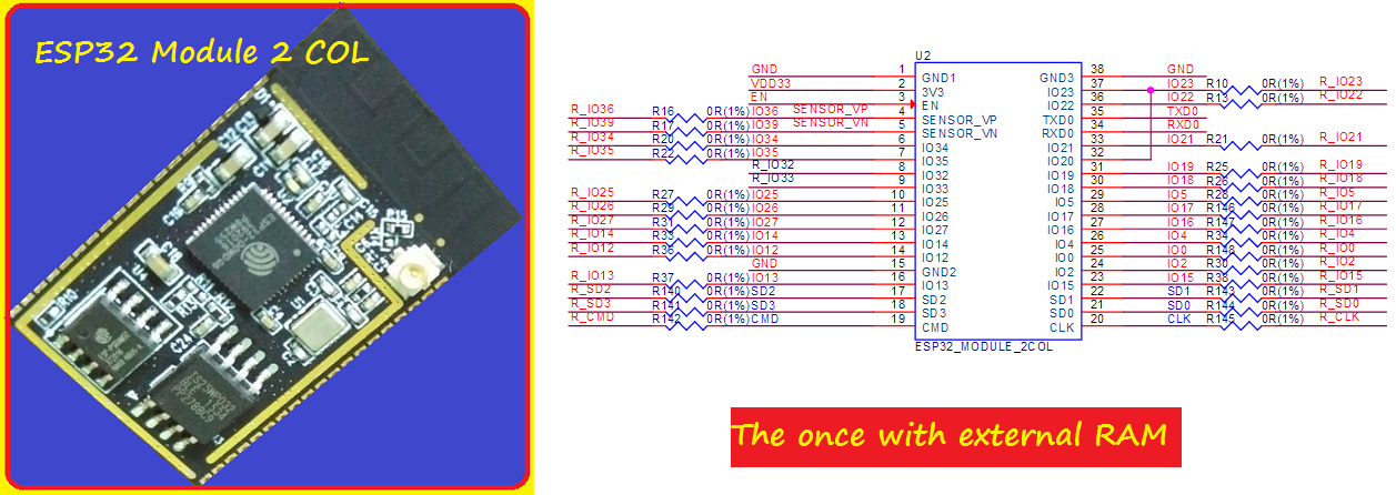

hi guys,
the spotted new esp32 modul with external ram is noted in the shematic DevKitJ
ESP32-DevKitJ-v1_sch.pdf
(63.8 KiB) Downloaded 1072 times

Posted: Fri Dec 30, 2016 3:24 am
by Angus
This is correct, the module is ESP32-WROVER and has external PSRAM.
ESP-WROVER-KIT is the other name for DevKitJ, it's designed to make use of this module.

hi Angnus,
txs, do you can "whisper",
is this "PSRAM" an own ESPRESSIF IC cause looks like espressif logo and begin is with "ESP" :mrgreen:
and have you the detailed name ( ESP-????? ) on the hand

got the identifers .. numb3rs
ESP-PSRAM32
372016
= produced 37 week in 2016
