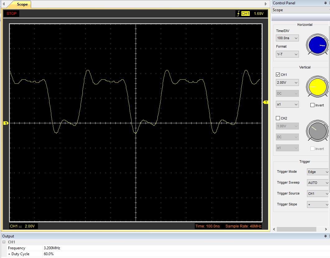

I would like to capture audio via a mems microphone on the pdm bus.
I've already purchased an esp32-wroom-32 card with which I'm starting to try. using the configuration below I checked with the oscilloscope that the shape of the clock is poor and also has a duty cycle of 60% contrary to the PDM bus standard.
my question is: is the signal shape expected or is this shape indicative of a problem?
I'm using the configuration below.
Thanks, Paolo

What kind of scope are you using, e.g. the bandwidth and sample rate ?
It's also related to the way you connect the signal and ground.

I have used a Hantek6022BE bandwith of 20MHz e 48MS/sec. the probe ground was the esp32-wroom-32 GND pin and the probe pin is the IO4 (ws_io_in). of course I have try many other pin bat with no difference. The duty cicle it's result about 60% that is a upper limit for the i2s bus of the mic i want to use. I have five peace of ESP32-WROOM-32 board and all have the same 60% dutycicle when I use I2s PDM. however, if I use i2s standard (NO PDM) at 3 MHz clock the BCLK and WS have very good shape with perfect falling and rising front and no asimmetric dutycicle. all ather board signal are ok! only the ws_io_in clock in PDM mode of I2S_0 present this problem.
would you have any suggestions?
thanks, Paolo
thanks, Paolo
