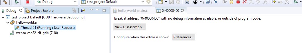

I'm facing issue with start debugging under Eclipse...
Command:
bin/openocd -s share/openocd/scripts -f interface/jlink.cfg -f board/esp-wroom-32.cfg
Output:
Open On-Chip Debugger 0.10.0-dev (2018-11-05-04:10)
Licensed under GNU GPL v2
For bug reports, read
adapter speed: 20000 kHz
esp32 interrupt mask on
Info : No device selected, using first device.
Info : J-Link ARM / Flasher ARM V4 compiled Aug 23 2018 09:52:26
Info : Hardware version: 4.02
Info : VTarget = 3.314 V
Info : clock speed 20000 kHz
When I'm trying launch debug, here is output in console:
Info : Target halted. PRO_CPU: PC=0x40000400 (active)    APP_CPU: PC=0x40000400
Info : Target halted. PRO_CPU: PC=0x4009171A (active)    APP_CPU: PC=0x40000400
Info : Flash mapping 0: 0x10020 -> 0x3f400020, 36 KB
Info : Flash mapping 1: 0x20018 -> 0x400d0018, 78 KB
Info : Auto-detected flash size 4096 KB
Info : Using flash size 4096 KB
Info : Using flash size 80 KB
Info : Using flash size 40 KB
Warn : negative reply, retrying
Warn : acknowledgment received, but no packet pending
Info : esp32: Debug controller 0 was reset (pwrstat=0x5F, after clear 0x0F).
Info : esp32: Core 0 was reset (pwrstat=0x5F, after clear 0x0F).
Info : Target halted. PRO_CPU: PC=0x5000004B (active)    APP_CPU: PC=0x00000000
Info : esp32: Core 0 was reset (pwrstat=0x1F, after clear 0x0F).
Info : esp32: Debug controller 1 was reset (pwrstat=0x5F, after clear 0x0F).
Info : esp32: Core 1 was reset (pwrstat=0x5F, after clear 0x0F).
And what I've got in Eclipse:
Debuggin from console starts fine (log):
$ xtensa-esp32-elf-gdb -x gdbinit_ build/hello-world.elf
GNU gdb (crosstool-NG crosstool-ng-1.22.0-80-g6c4433a5) 7.10
Copyright (C) 2015 Free Software Foundation, Inc.
License GPLv3+: GNU GPL version 3 or later <http://gnu.org/licenses/gpl.html>
This is free software: you are free to change and redistribute it.
There is NO WARRANTY, to the extent permitted by law.  Type "show copying"
and "show warranty" for details.
This GDB was configured as "--host=i686-host_pc-mingw32 --target=xtensa-esp32-elf".
Type "show configuration" for configuration details.
For bug reporting instructions, please see:
<http://www.gnu.org/software/gdb/bugs/>.
Find the GDB manual and other documentation resources online at:
<http://www.gnu.org/software/gdb/documentation/>.
For help, type "help".
Type "apropos word" to search for commands related to "word"...
Reading symbols from build/hello-world.elf...done.
0x4000941d in ?? ()
JTAG tap: esp32.cpu0 tap/device found: 0x120034e5 (mfg: 0x272 (Tensilica), part: 0x2003, ver: 0x1)
JTAG tap: esp32.cpu1 tap/device found: 0x120034e5 (mfg: 0x272 (Tensilica), part: 0x2003, ver: 0x1)
Hardware assisted breakpoint 1 at 0x400d24bb: file C:/Projects/ESP32/Projects/hello_world/main/hello_world_main.c, line 101.
Any ideas where I should dig?..
