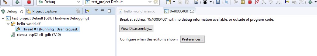

I'm facing issue with start debugging under Eclipse...
Command:
Output:
When I'm trying launch debug, here is output in console:
And what I've got in Eclipse:
Debuggin from console starts fine (log):
Any ideas where I should dig?..

Info : Target halted. PRO_CPU: PC=0x40000400 (active) APP_CPU: PC=0x40000400Debuggin from console starts fine (log):
$ xtensa-esp32-elf-gdb -x gdbinit_ build/hello-world.elf
GNU gdb (crosstool-NG crosstool-ng-1.22.0-80-g6c4433a5) 7.10
Copyright (C) 2015 Free Software Foundation, Inc.
License GPLv3+: GNU GPL version 3 or later <http://gnu.org/licenses/gpl.html>
This is free software: you are free to change and redistribute it.
There is NO WARRANTY, to the extent permitted by law. Type "show copying"
and "show warranty" for details.
This GDB was configured as "--host=i686-host_pc-mingw32 --target=xtensa-esp32-elf".
Type "show configuration" for configuration details.
For bug reporting instructions, please see:
<http://www.gnu.org/software/gdb/bugs/>.
Find the GDB manual and other documentation resources online at:
<http://www.gnu.org/software/gdb/documentation/>.
For help, type "help".
Type "apropos word" to search for commands related to "word"...
Reading symbols from build/hello-world.elf...done.
0x4000941d in ?? ()
JTAG tap: esp32.cpu0 tap/device found: 0x120034e5 (mfg: 0x272 (Tensilica), part: 0x2003, ver: 0x1)
JTAG tap: esp32.cpu1 tap/device found: 0x120034e5 (mfg: 0x272 (Tensilica), part: 0x2003, ver: 0x1)
esp32: Debug controller 0 was reset (pwrstat=0x5F, after clear 0x0F).
esp32: Core 0 was reset (pwrstat=0x5F, after clear 0x0F).
Target halted. PRO_CPU: PC=0x5000004B (active) APP_CPU: PC=0x00000000
esp32: Core 0 was reset (pwrstat=0x1F, after clear 0x0F).
esp32: Debug controller 1 was reset (pwrstat=0x5F, after clear 0x0F).
esp32: Core 1 was reset (pwrstat=0x5F, after clear 0x0F).
Hardware assisted breakpoint 1 at 0x400d24bb: file C:/Projects/ESP32/Projects/hello_world/main/hello_world_main.c, line 101.

This issue was solved by connecting power line of esp32 to segger jTag.
Thanks
Arun
