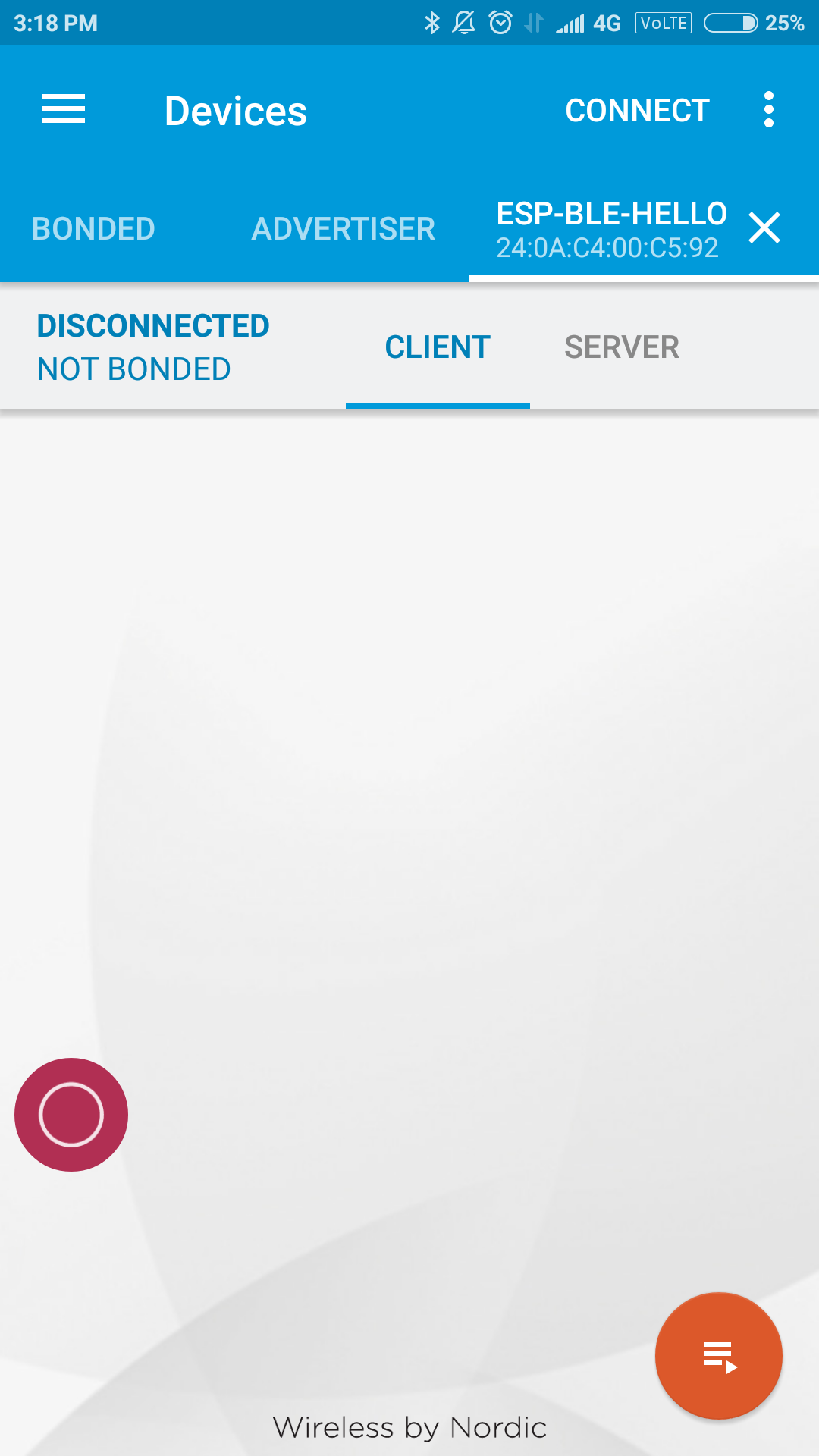

Re: cannot pair esp32 with android device using
Don't try to pair, just use nrf connect app or similar

I tried with nrfconnect app but it shows like attached image .
It shows NOTBONDED
It must be bonded ryt?? Then n then my esp32 and mobile device will connect with each other.

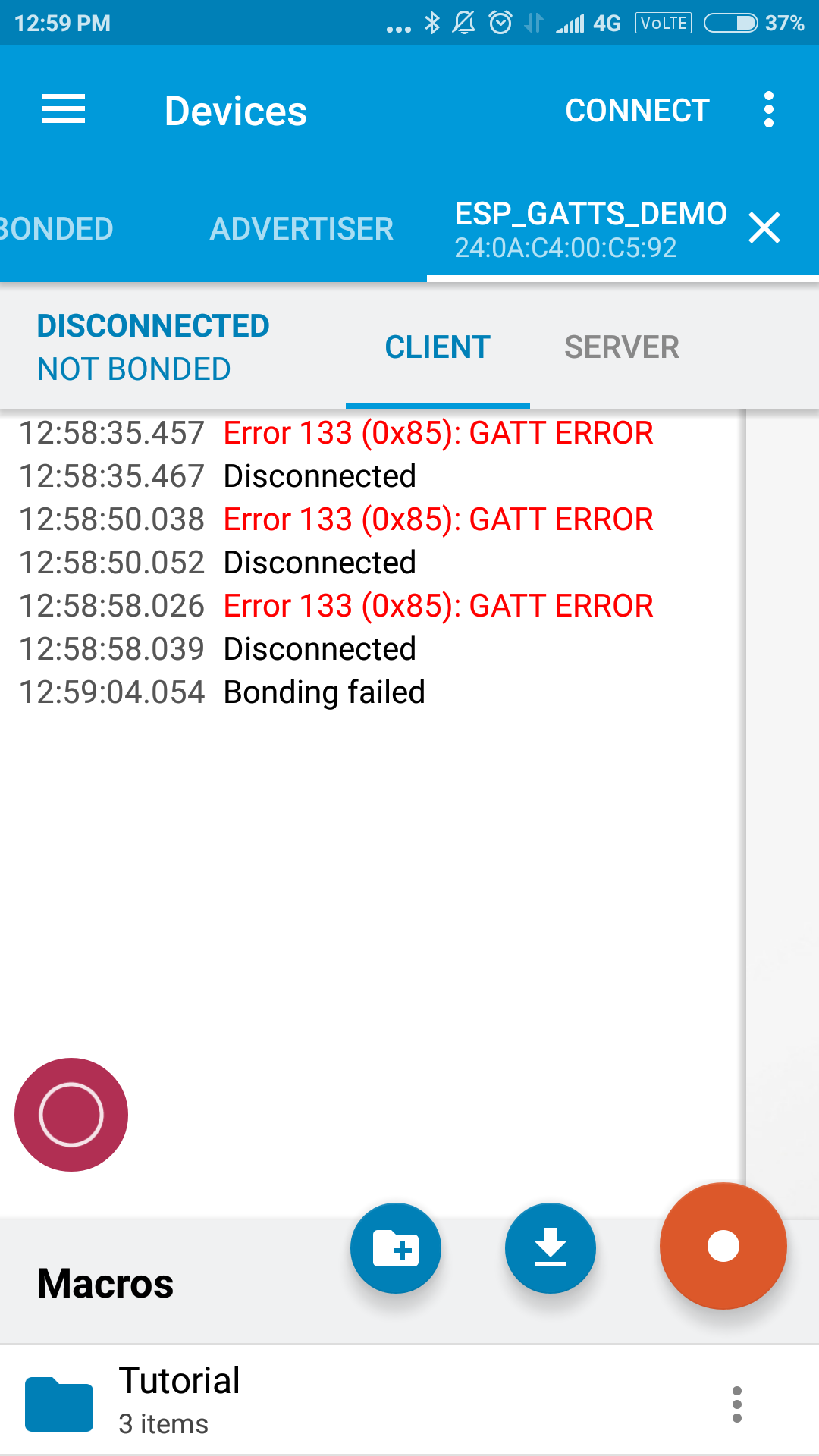

What are you expecting to happen by connecting your phone to the esp32 over Bluetooth LE?
There's nothing running there by default to offer any kind of service, it's just doing exactly what you told it to - broadcast advertising packets - nothing more.
If you want to connect with your phone and se some sample values try the gatt_server example and then use the nRF app.

hello ,
I tried with gatt_server example ans try to connect my mobile with esp32 using ntfconnect app its shows as shown in attached image error:
