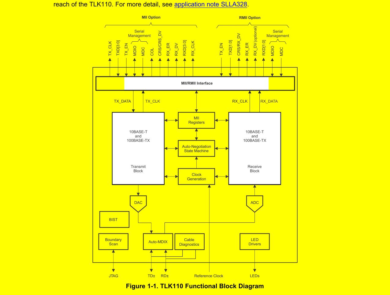

Are their any reference schematic or document that use the RMII to interface to 10/100 Ethernet Transceiver?

Can anyone answer this? I want to configuration the EMAC to RMII interface with internal clock source and output the 50MHz RMII CLK to GPIO16/EMAC_CLK_OUT pin, is it possible?

It is the ethernet PHY module I used, which has an 50Mhz crystal on board. I hooked it up
https://www.aliexpress.com/store/produc ... 94874.html
I used connections as laid out in example code here.
https://github.com/espressif/esp-idf/bl ... net_main.c
with addition of EMAC_RX_CRS_DV to GPIO to GPIO27 but the code fails to get an IP. It's stuck at emac reset done

hi
only for the protocoll :)
you have a LAN8720-ETH Modul
you use the ethernet example code with TLK110 ETH and config, cmd and pins
be sure you use the right configs for LAN8720 example RMII_CLK_enable is difference CMD to TLK110
you must read the LAN8720 Datasheet and the TLK110 Datasheet and you can then create the header for the LAN8720 ETH Board with right cmd bits
i ordered same LAN8720 ETH module now, hope i get it fast next days.
