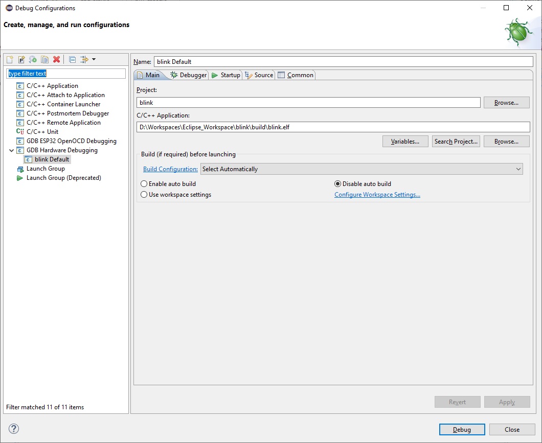

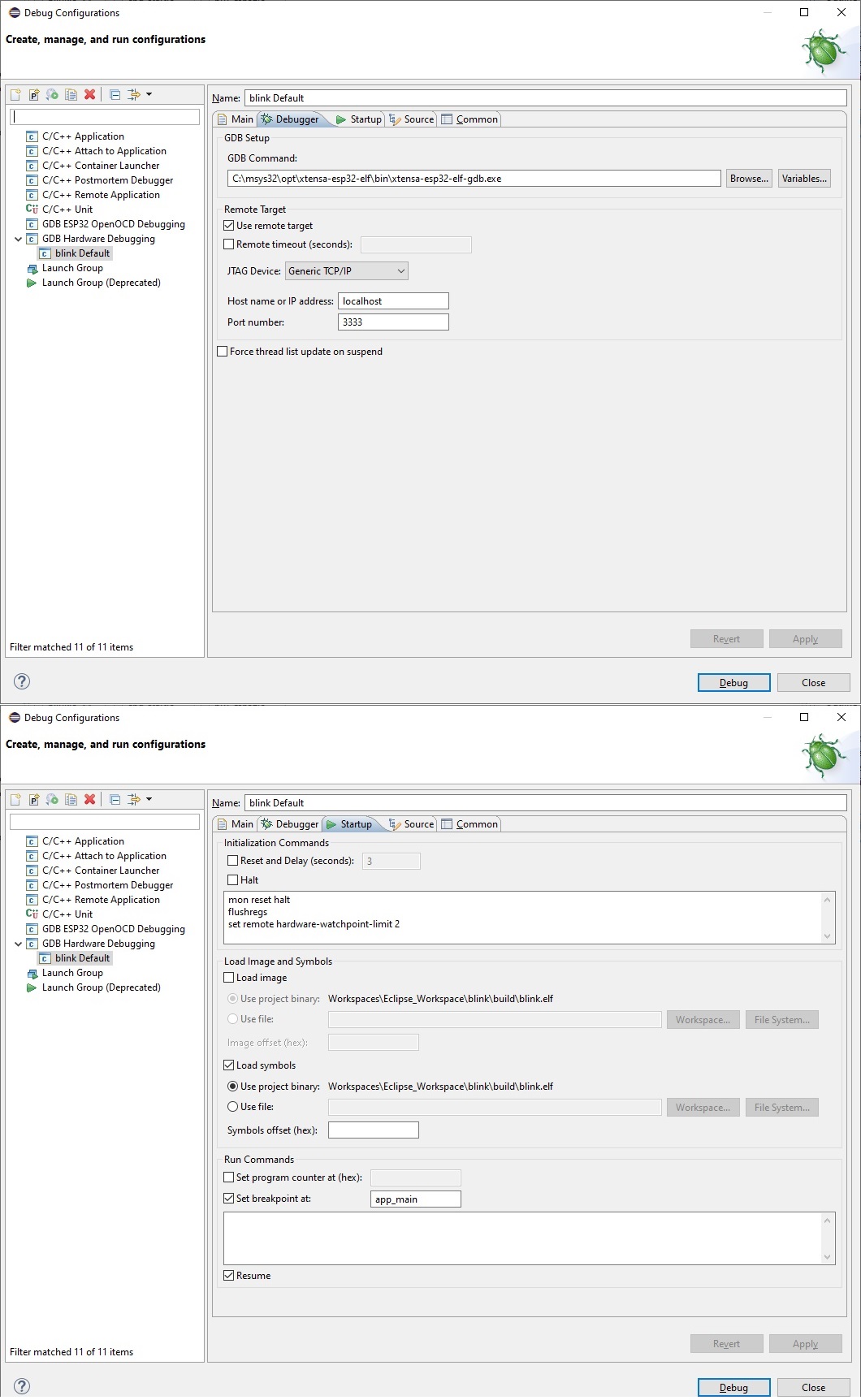

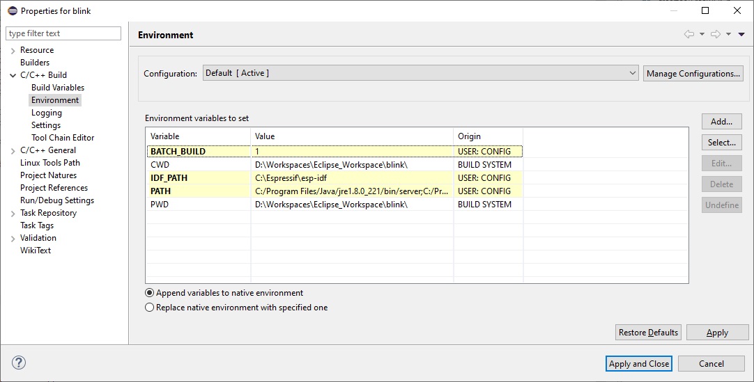

Change the "/" to "\" on IDF_PATH variable on your settings.
I just made a new setup on eclipse to check...
I used https://dl.espressif.com/dl/esp-idf-tools-setup-1.2.exe to install the openocd.
The setup work OK...ish...
Here is my setup:

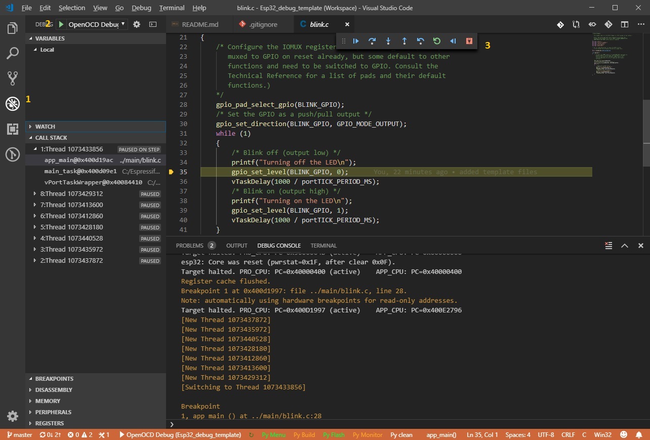

Re: Debugging with VS Code?
I made an ESP32 debug template project for VsCode that work's just fine: https://github.com/botofancalin/Esp32_debug_template
https://raw.githubusercontent.com/botofancalin/Esp32_debug_template/master/img/Esp32_win_gdb_debug.jpg
You can use this template as a starting point for your project ...

Re: ESP32 - Debugging using Eclipse [solved]
That may be caused by some wrong environment variables or environment paths setup on Eclipse.
I was using Eclipse for build/debug software on ESP32 some time ago and i found it very hard and time consuming to set up a esp32 project on Eclipse.
Moving the project to a different PC is a headache too ...
The gdb response looks OK.
There must be something wrong on eclipse debug settings...
On step 6 from eclipse debug instructions, click "Browse" and select the xtensa-esp32-elf-gdb.exe on your PC
