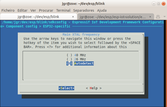

- Sun Jan 06, 2019 12:21 am
- Forum: Hardware
- Topic: Reading DS18b20 sensors using ESP-IDF using a ESP32 with a 26 MHx XTAL
- Replies: 3
I'm able to read DS18B20 sensors using the example code provided in this repository https://github.com/DavidAntliff/esp32-ds18b20-example .
It works well using a standard Espressif ESP32-WROOM-32 (aka ESP32-DevKitC), which uses a 40 MHz XTAL.
I'm not able to run the same example using an Allnet ...

Re: IDF Monitor output is garbled
I had the same problem with an ESP32+OLED https://www.allnet.de/lp/iot-wlan-display/
I've set the Main XTAL frequency to Autodetect and it works.
