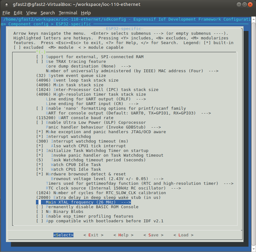

In my scenario:
After flashing my Dev-Board by another computer, My spiffs partition popout only garbage now. So I erase the whole SPI-Flash chip with command "make erase_flash" and then manually select the speed of my XTAL as here descript. And everything works again! :lol:
Component_config -> ESP32-specific -> Main_XTAL_frequency
So I change the speed manually
P.s:
What I still not clear is: Why this happened at all! Strange!

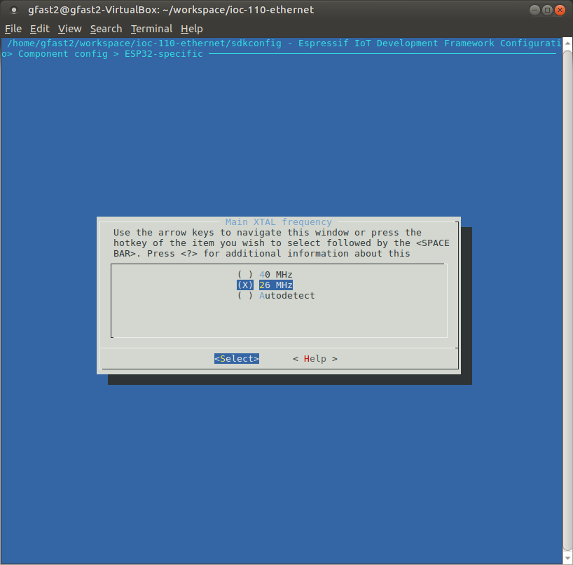

Postby jgrocha » Thu Dec 06, 2018 8:13 pm
I had the same problem with an ESP32+OLED https://www.allnet.de/lp/iot-wlan-display/
I've set the Main XTAL frequency to Autodetect and it works.
