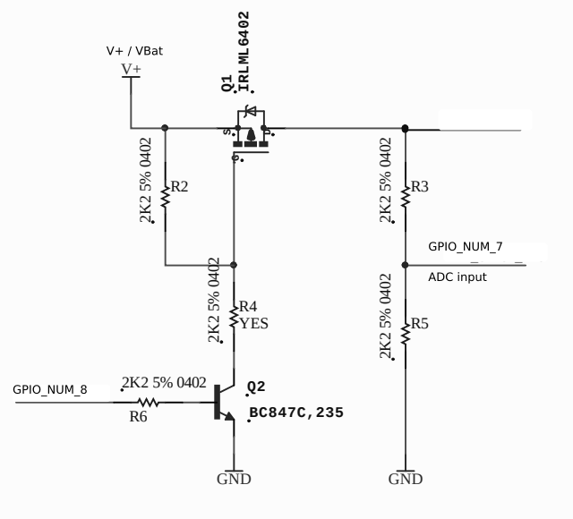

We are having issue getting the correct reading from our custom board with ESP32-S3-WROOM-1 module. In our design, we have connected ADC1_CHANNEL_6 (GPIO_NUM_7) in between two resistors, forming a voltage divider. The expected voltage range there is 1V5 to 2V7, which is of our battery power input.
During development we have connected a bench power supply instead of a battery, in series with a voltmeter. We are using this code to acquire the voltage reading:

This gives stable readings, as in all samples are within 10mV. But they are wrong! Sometimes up to 150mV! The offset is different each time we power cycle the system.
BUT when we reset the system, by pulling RST to GND, the readings suddenly get very accurate (+-4mV), the offset disappears!
We did not burn any eFuse or set Two-Point calibration values; we are using the module as it shipped.
Are we doing something wrong?

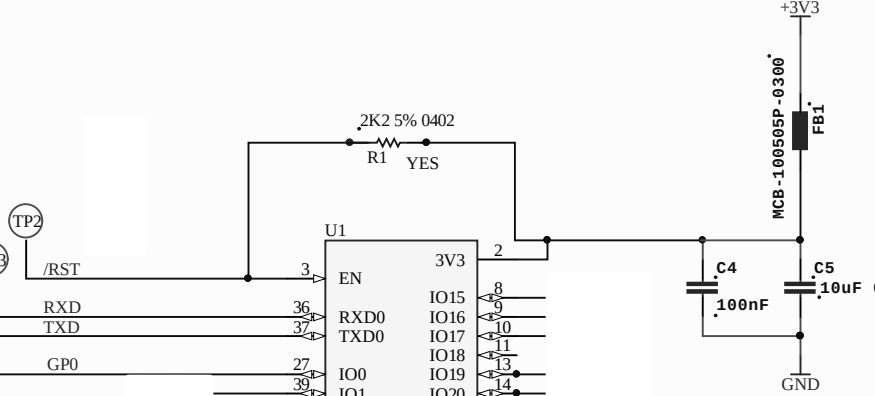

Added schematic snapshots of the reset and ADC circuit.
Posts: 10596
Re: ESP32-S3 ADC reading issue
Postby Sprite » Fri Sep 02, 2022 12:16 pm
That does not look like a proper power-on-reset circuit: we advise an 10K pullup and an 100nF to 1uF capacitor to ground connected to the EN of the chip.
