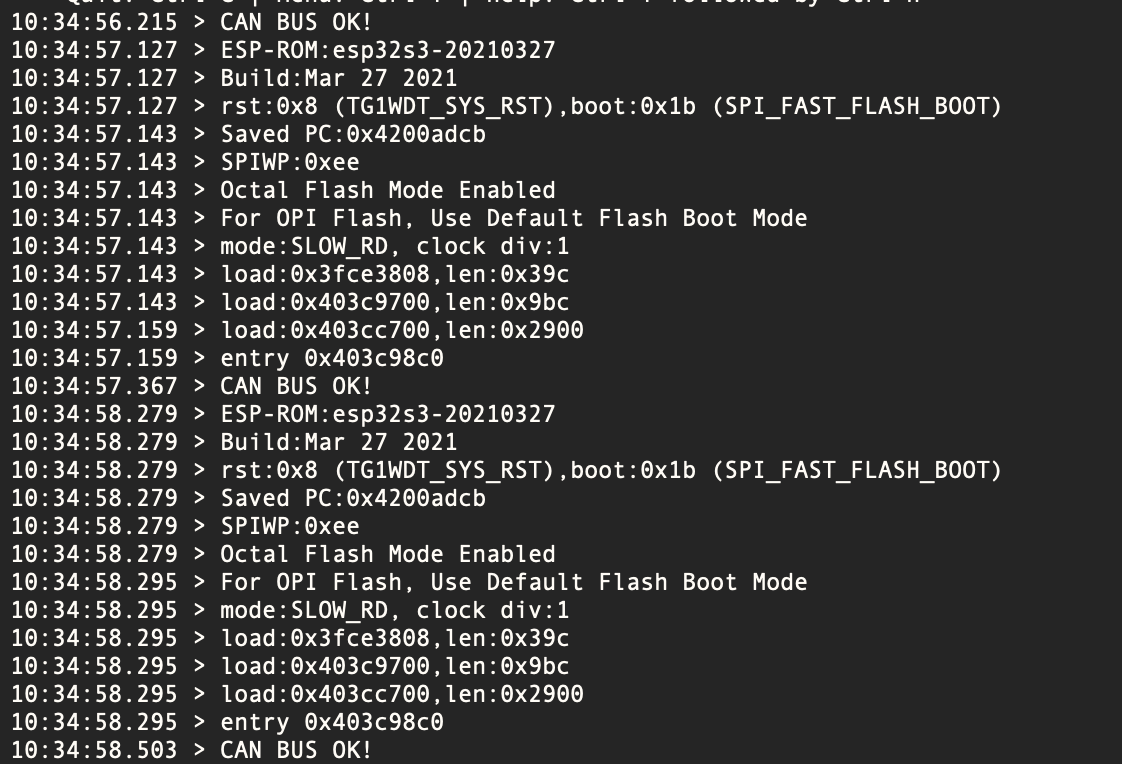

Hello everyone,
I need to establish a Can bus link between an ESP32 and an Arduino Uno but my ESP32 crashes when launching the code.
The program uploads correctly but once in the monitor, it never reaches the loop and continuously redoes the setup.
Has anyone had this problem or knows how to fix it?
My code below:

    CAN.sendMsgBuf(0x01, CAN_STDID, 8, buf); // <- main suspect for the esp32 crash
    delay(100);
// END FILE
The monitor view
Capture d’écran 2023-02-09 à 10.35.14.png (230.3 KiB) Viewed 1623 times

Postby Beubeu » Fri Feb 10, 2023 2:56 pm
Ok in the library, there was just missing a "return 0;" :D
My code is all good but the
Code: Untitled.c Select all
sendMsgBuf
was wrong...
Never missed the return 0; if your function is not a void for ESP32 :p
