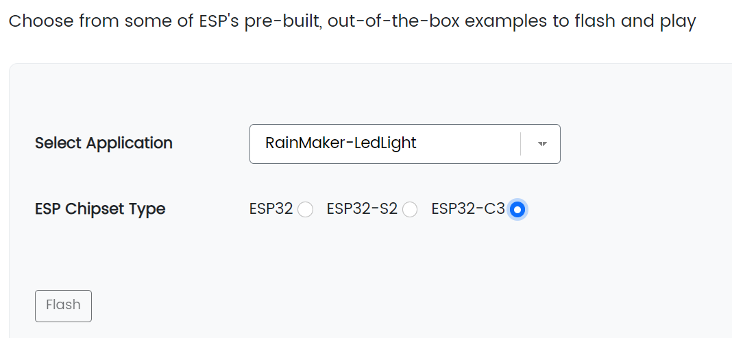

Hi Team,
I am having ESP32-C3-DevKitC-02 with me and I am trying to run the matter. so I have gone through the following link
https://docs.espressif.com/projects/esp ... ction.html
in which I found the launchpad option which is to test Matter on Espressif devices without any additional setup.
So I tried that with following link :
https://espressif.github.io/esp-launchpad/

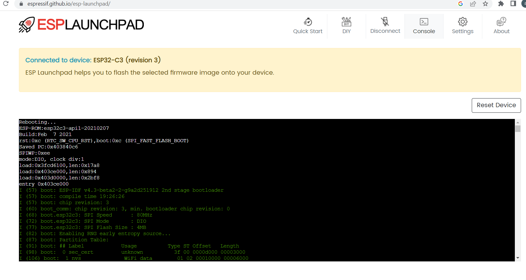

there I have selected C3 and application as RainMaker-LedLight (Image), then flashed the pre-built package through browser by selecting the port Image. After that I have installed the rain-maker app in my android-device. when I tried to add device in the app after scanning the QR code or BLE (I didn't got pairing pop up in my phone). I am facing error in the mobile app as "Error! Device disconnected" screenshot is attached ()Image.

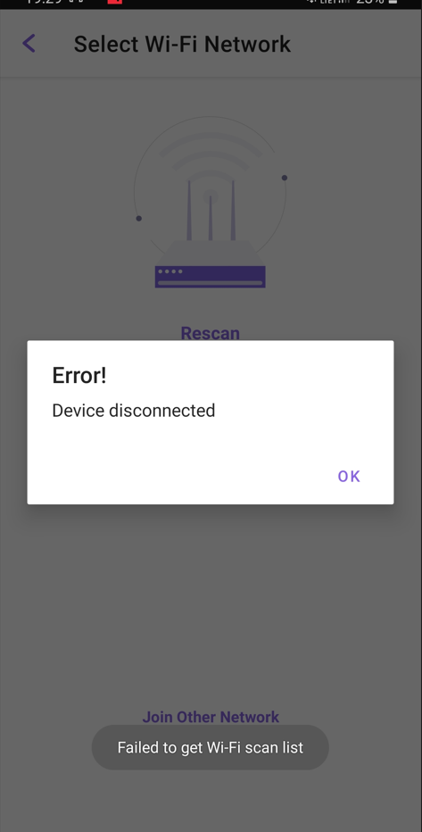

in the console I am able to see following error, after that it reboots
W (55388) wifi:Error! Should use default active scan time parameter for WiFi scan when Bluetooth is enabled!!!!!!
Guru Meditation Error: Core 0 panic'ed (Instruction access fault). Exception was unhandled.

I am providing the detailed log below

ELF file SHA256: 55af42c4ad14898f
Rebooting...
ESP-ROM:esp32c3-api1-20210207
Build:Feb 7 2021
rst:0xc (RTC_SW_CPU_RST),boot:0xc (SPI_FAST_FLASH_BOOT)
Saved PC:0x403840c6
SPIWP:0xee
mode:DIO, clock div:1
load:0x3fcd6100,len:0x17a8
load:0x403ce000,len:0x894
load:0x403d0000,len:0x2bf8
entry 0x403ce000
