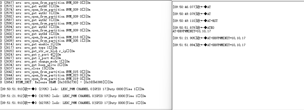

使用AT2.4版本编译,启用CONFIG_AT_DRIVER_COMMAND_SUPPORT编译下载后,发送命令AT+DRVADC=0,0正常响应,发送命令AT+DRVPWMINIT=10000,10,17没有正确回复,回复值为ready
AT+DRVPWMINIT=100
[11:10:10.617]收←◆\0

AT命令发送:
AT+RST
ATE1
AT命令响应:
ready
AT
OK
AT+RST
OK
ready
AT+DRVPWMINIT=100
[11:10:10.617]收←◆\0
AT驱动命令编译后指令异常

请提供下输出日志口(UART0 管脚请参考:https://docs.espressif.com/projects/esp ... n.html#id1)的 log。

[09:50:45.861]收←◆ets Jun 8 2016 00:22:57

[09:50:46.061]收←◆[0;32mI (201) esp_image: segment 1: paddr=0012e248 vaddr=3ffbdb60 size=01dd0h ( 7632) load[0m

[09:50:46.769]收←◆[0;33mW (916) clk: 32 kHz XTAL not found, switching to internal 150 kHz oscillator[0m

[0;32mI (1330) sleep: Configure to isolate all GPIO pins in sleep state[0m
D (1332) intr_alloc: Connected src 24 to int 9 (cpu 0)[0m
[0;32mI (1333) cpu_start: Starting scheduler on PRO CPU.[0m

D (2633) nvs: nvs_get keep_alive 2[0m
D (2636) nvs: nvs_close 13[0m
D (2642) nvs: nvs_open_from_partition NVM_015 0[0m
D (2644) nvs: nvs_open_from_partition NVM_023 0[0m
D (2648) nvs: nvs_open_from_partition NVM_019 0[0m
D (2653) BTDM_INIT: Release DRAM [0x3ffb2730] - [0x3ffb6388][0m
[09:50:49.128]收←◆D (3280) event: running post WIFI_EVENT:13 with handler 0x40167ee0 and context 0x3ffbd644 on loop 0x3ffb7ea4[0m
D (3280) esp_netif_handlers: esp_netif action stopped with netif0x3ffbd6a8 from event_id=13[0m
D (3287) esp_netif_lwip: check: remote, if=0x3ffbd6a8 fn=0x40158c24
[0m
D (3294) esp_netif_lwip: check: local, if=0x3ffbd6a8 fn=0x40159680
[0m
D (3300) esp_netif_lwip: esp_netif_update_default_netif_lwip 0x3ffbd6a8[0m
D (3307) esp_netif_lwip: call api in lwip: ret=0x0, give sem[0m
D (3312) event: running post WIFI_EVENT:13 with handler 0x400f986c and context 0x3ffb2db0 on loop 0x3ffb7ea4[0m
I (3322) wifi:flush txq
I (3324) wifi:stop sw txq
I (3327) wifi:lmac stop hw txq
D (3329) ADC: Wi-Fi returns adc2 lock.[0m

[09:50:51.910]收←◆D (2705) ledc: LEDC_PWM CHANNEL 0|GPIO 17|Duty 0000|Time 1[0m
[09:51:21.912]收←◆D (32705) ledc: LEDC_PWM CHANNEL 0|GPIO 17|Duty 0000|Time 1[0m
[09:51:51.910]收←◆D (62705) ledc: LEDC_PWM CHANNEL 0|GPIO 17|Duty 0000|Time 1[0m

你的异常是指没有返回 OK 还是出现了 ready 。ready一般说明系统出现了复位,但是我看你的LOG,没看到复位的LOG。
另外,PWM 这块我们建议你们也可以使用我们的 LEDC 自定义命令来做,这样做出来的命令更灵活。

Re: AT驱动命令编译后指令异常
AT+DRVPWMINIT=100
这个是命令返回值,没有返回OK,也没有返回ERROR,而且我命令是关闭回显的。
你们测试可以正常使用这个命令吗。
我的AT工程只是在配置的时候有选择AT_DEV,然后编译。
我现在需要的只是驱动一个LED指示联网状态。
或者你们这边可以提供一个开启这部分命令的.bin文件给我验证一下吗
你们测试可以正常使用这个命令吗。
