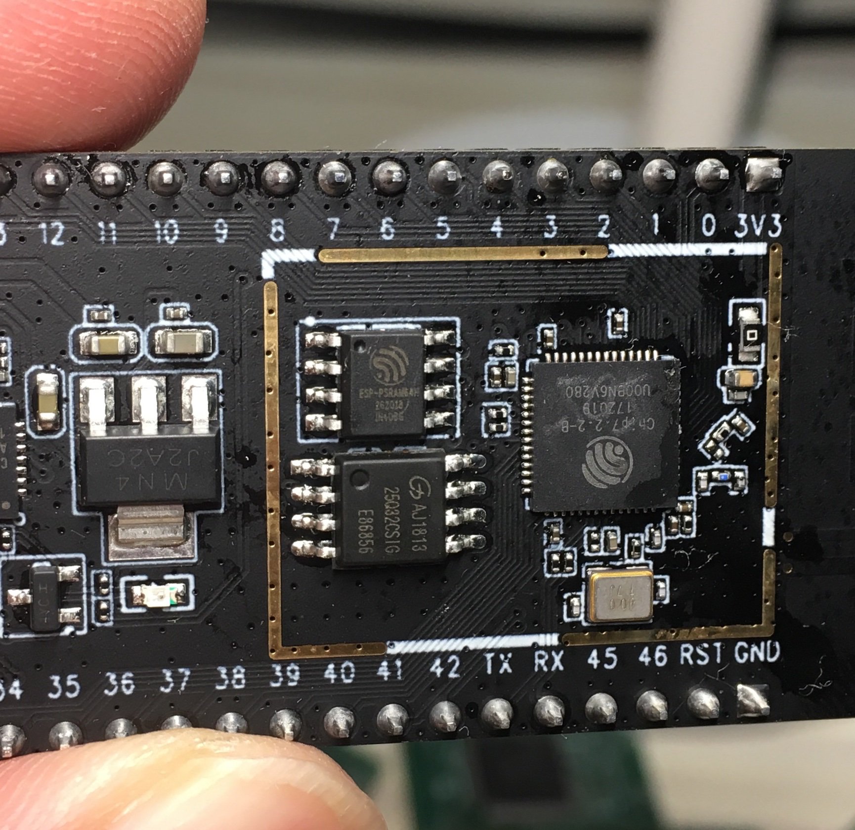

which new "esp" 8 pin ic is this on the new esp32 modul? ;-)
WiFive
Posts: 3529
Re: which new "esp" 8 pin ic is this on the new esp32 modul? ;-)
Postby WiFive » Sat Jul 15, 2017 9:45 pm
Yes, important info to keep straight
SD pins are for SDIO slave function
HS1 pins are for SDIO/MMC master function
SPI pins are for SPI/QPI
Need warning: Do not try to make QPI device into SDIO device (by imagination) :!:
Actually would be helpful to have SPI_IO0-3 labels too
Posts: 1759
Postby rudi ;-) » Sun Jul 16, 2017 4:18 pm
where you know my imagination thinking? :mrgreen:
+1
btw.
now i know, why the most did wrong on SD Card implemention on start.
they did think this silkscreen is for SD Card too - ( little confusing ) but now we know.

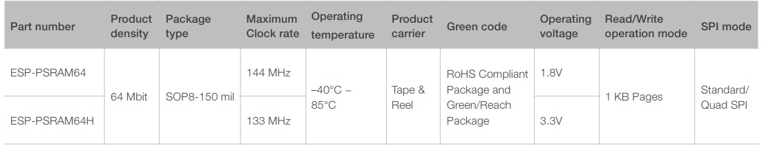

ESP-PSRAM64 & ESP-PSRAM64H
Postby rudi ;-) » Thu Jun 21, 2018 7:39 am
update
ESP-PSRAM64 and ESP-PSRAM64H are 64 Mbit serial pseudo SRAM devices that are organized in 8Mx8 bits.
They are fabricated using the high-performance and high-reliability CMOS technology.
ESP-PSRAM64 operates at 1.8V and can offer high data bandwidth at 144 MHz clock rate, while
ESP-PSRAM64H operates at 3.3V and can support up to 133 MHz clock rate. Note, however, that
burst operations which cross page boundaries have a lower max input clock frequency at 84 MHz.
Both of the PSRAM devices can be accessed via the Serial Peripheral Interface (SPI). Additionally, a
Quad Peripheral Interface (QPI) is supported if the application needs faster data rates. The devices
also support unlimited reads and writes to the memory array.
Details taken from the Datasheet [ SRC ]
esp-psram64_esp-psram64h_datasheet_en.pdf
2018.06.15
V 1.0
(1.28 MiB) Downloaded 1015 times

btw:
have a note about MP WROVER and update
ESP32-WROVER 64-Mbit PSRAM*
ESP32-WROVER-I 64-Mbit PSRAM*
Posts: 1759
Postby rudi ;-) » Sat Dec 01, 2018 12:14 am
edit/again:
saw it - did post the ESP-pSRAM64/H datasheet already -
ok then this theme on ESP64 is completly now @WiFive

Hi Folks,
ESP-PSRAM64H was found on Espressif's "Chip7 2-2-A" beta board / module
