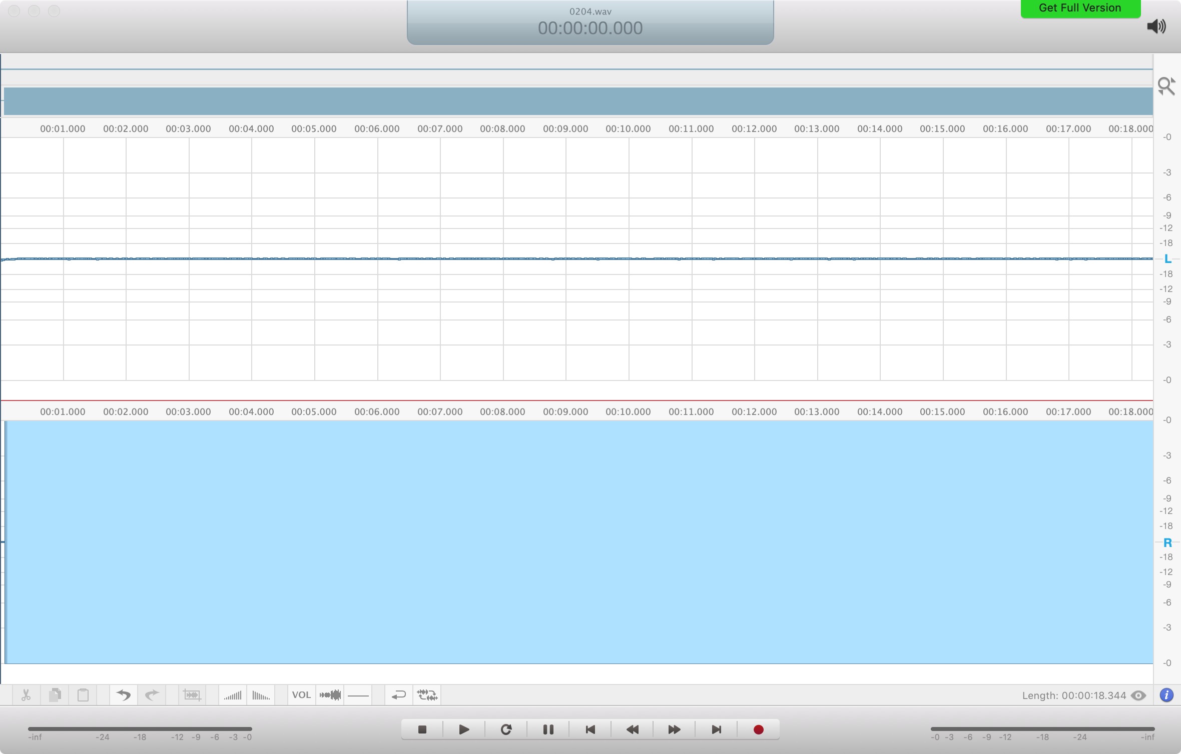

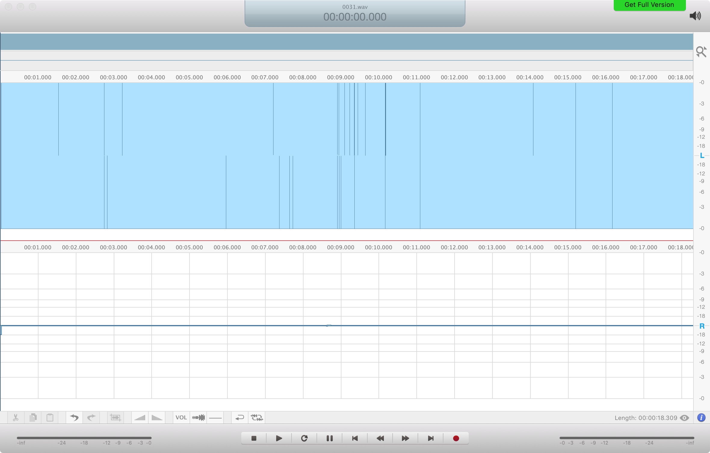

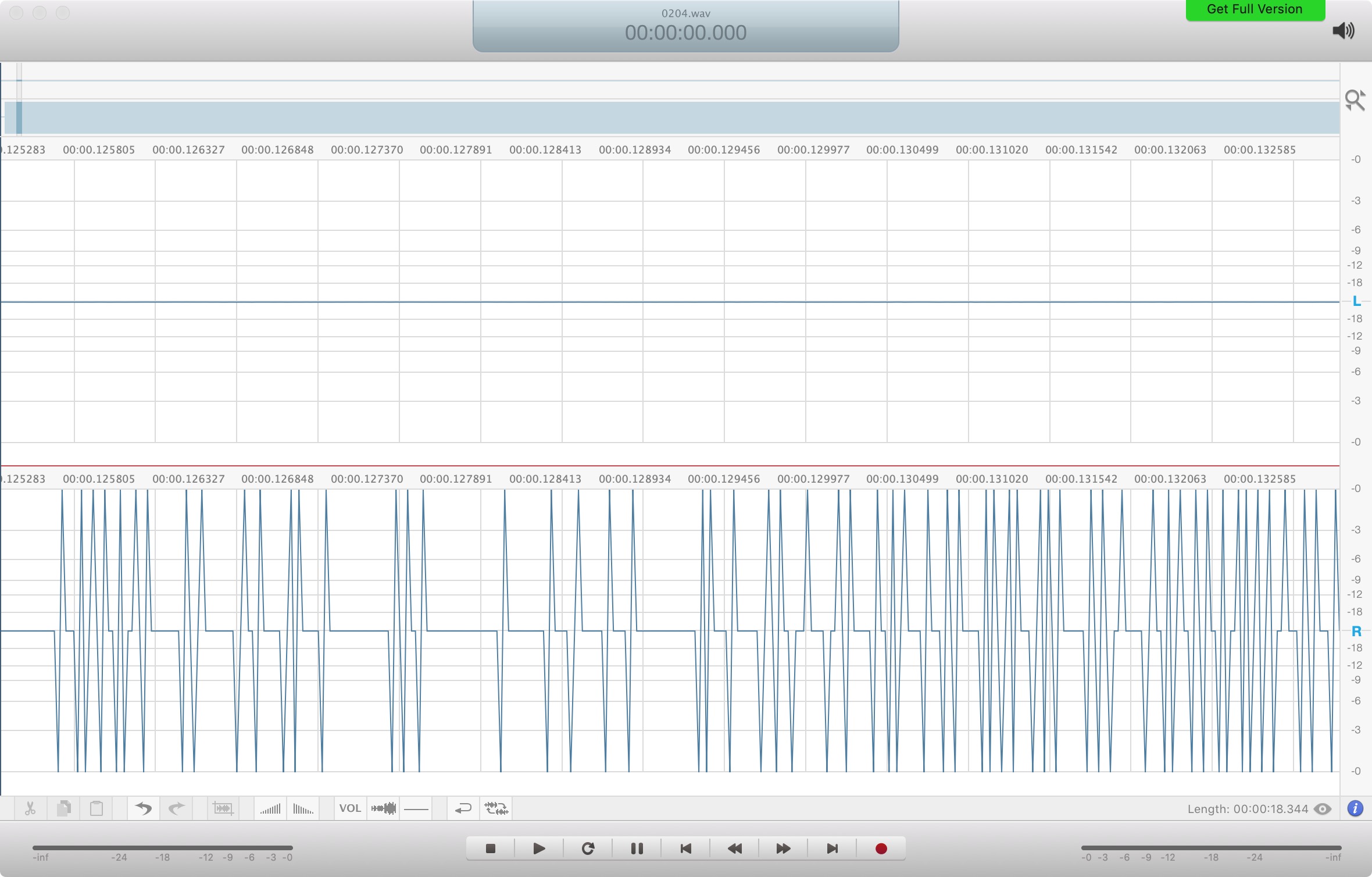

with some corrupted .wav diagrams.
the diagram of L channel data corrupted
the diagram of R channel data corrupted
the diagram of zoom-in detail data corrupted
