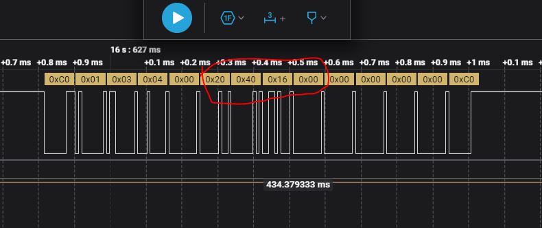

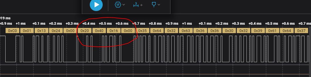

Hi Buddy,
I have attached my received capture, there I was highlighted particular area of data's, which I was receiving particular data in my all of receiving frame. Because of these data only, I suspect these data's only the reason Wi-Fi MCU not waking up after the MD5 verification step.
Here I couldn't understand the reason, why these data consecutively repeating in every frames ?
Help me out from this ! and share some procedure to avoid unwanted data repetition.
