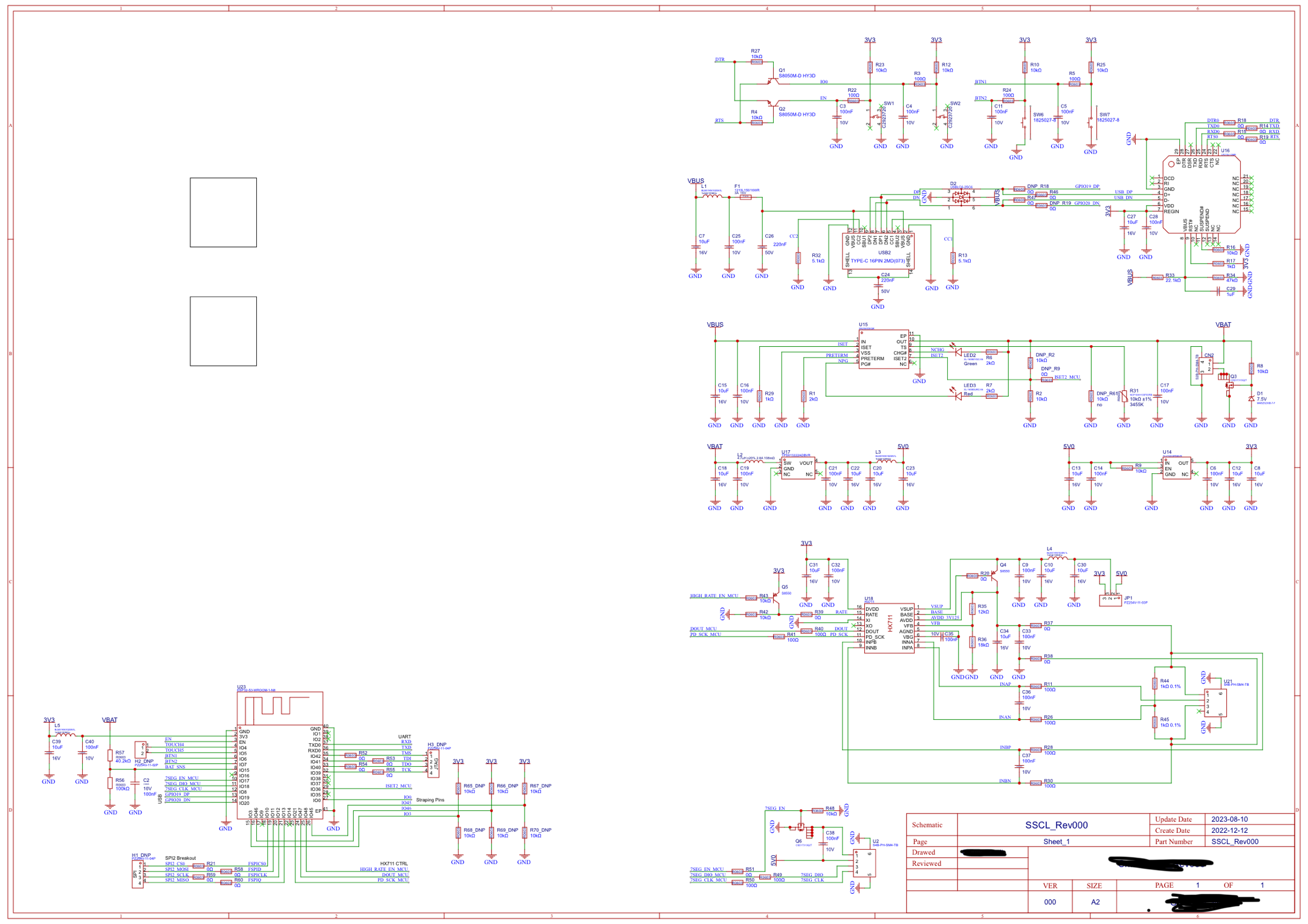

I have designed a custom PCB (my first one) with an ESP32, UART Bridge and some sensors.
I am able to connect it, and even to upload some code (with pushing the boot button).
However u don’t get any signal feedback on the serial.monitor. I tried different settings in Arduino IDE and Platform.IO.
Do you have any Tipp where I should looking at? I am really tying hard but can’t find the issue.
According to the BOM we have an ESP32-S3-WROOM-1-N8

Maybe its an issue with the way you generate rts/cts signals. I would try to use directly internal USB/JTAG i/f on pins 19/20. If i understood correctly your schematic, it just need a small rework.
This way you eliminate usb/uart bridge and be sure esp32 is booting properly.

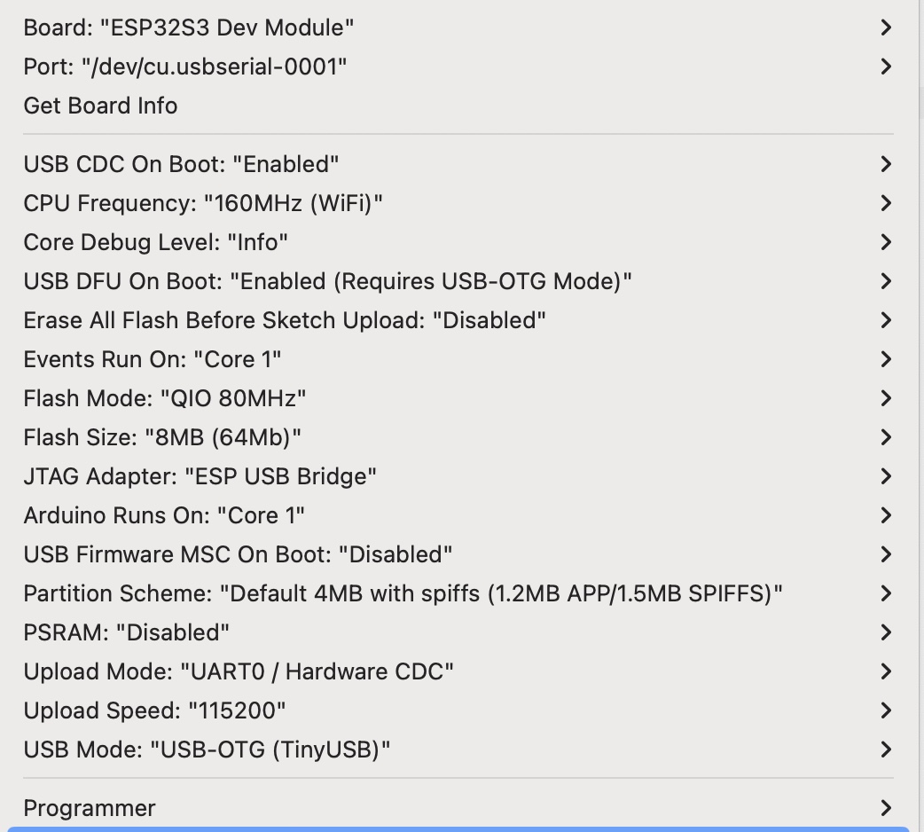

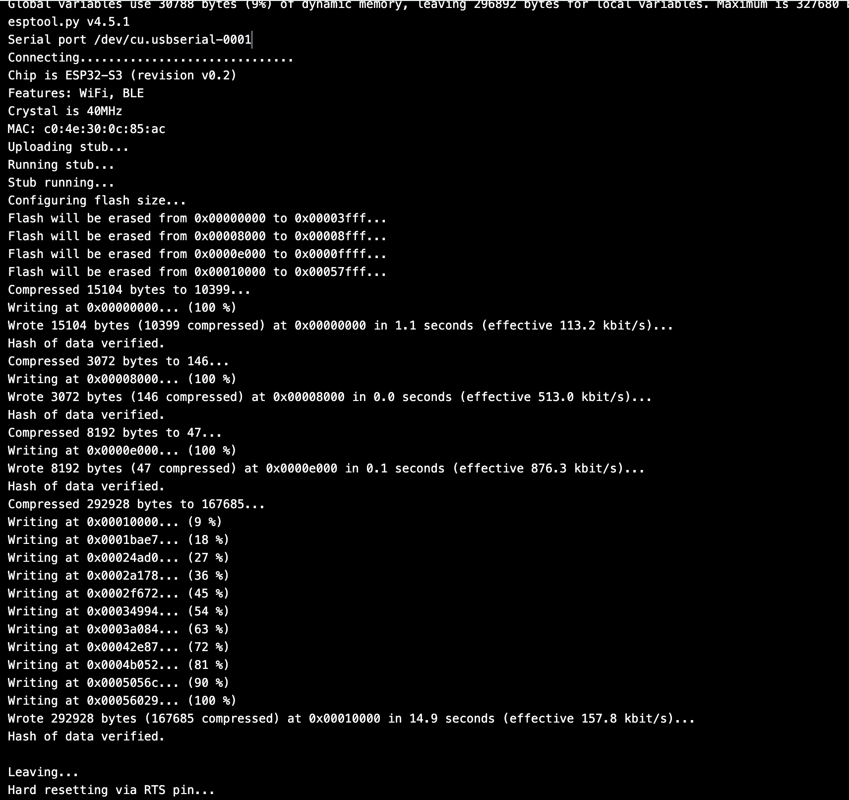

I setup the Arduino IDE as shown in the screenshot + the build and upload was successful at least according to the screenshot.
I tried to keep the code as clean as possible.
however I also tried it with Serial-println in the loop.
Regarding your tip. I need to cut a USB cable, attach the data cable to GPIO19 and 20 and try the same right? or which setting is required for this?
thank you very much!

Looks OK!
Not sure if you have a Serial.begin(); in your setup code.
If you have it and still not working, then try the usb cable.
Either you cut it and solder directly D+/D- and GND wires, or let it as it is, remove R46, R47 and place R18, R19 and plug it in the connector.
