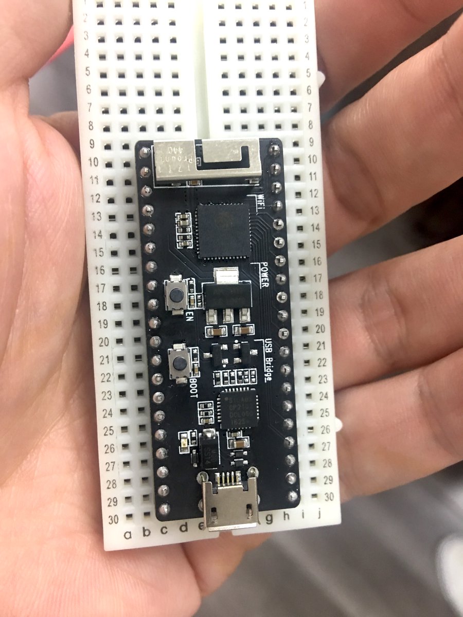

Small ?
;p
Ok ..
how you think over this ESP32-PICO breadboard modul ;-)
the most taken space is from USB, LDO and button parts.
the complet ESP32 SoC and crystal and flash and so on is in the PICO package.
( i like this - cause there are 2 rows free on a standard breadboard on each side now)
i wonder why marketing appart from espressif is so long waiting to bring this out as a "standard" breadboard modul.

Yes, this is the perfect breadboard module : all ESP32 pins available, borderless, with 2 breadboard rows accessible on each side.
Please Espressif, release it for us, mere mortals too ! :)

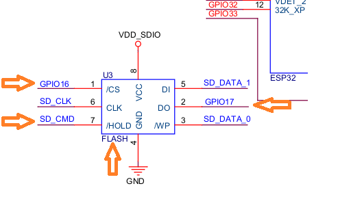

Oh ..
info taken from the datasheet
i do not believe this but i have to ask before i think detailed :
ESP32 SIP-D4
looks like there is no support for 1.8V pSRAM ?
is there a 3.3V Flash in the SIP ?
so we can use 3.3V pSRAM then over regular 3.3V power supply ?
so i can think we get a second SIP with eMbedded pSRAM ?
does VDD_SDIO never be connected in the SIP in future then?
i think then PIN26 Name better then N.C. VDD_SDIO_NC makes no sense, NC is NC and remains NC.
Posts: 1756
Re: Small ESP32 Modul ( all include in new ESP32-PICO )
Postby rudi ;-) » Wed Aug 23, 2017 8:44 am
There is a complete re-assignment of the SIG PINS?
Current PIN assignment:
IO16 and IO17 was CS and CLK for pSRAM
and also SD_CMD was a /CS
very confusing
Who can ever think of something?
but let see what comes in next time on desktop
and revise on documents -
to early to say what happens in initial revision and in this monolog.
ESP_igrr
Posts: 2076
Postby ESP_igrr » Wed Aug 23, 2017 10:34 am
That looks like the same arrangement of pins as in D2WD, is it not?
ESP32-D2WD’s pins GPIO16,GPIO17,SD_CMD,SD_CLK,SD_DATA_0 and SD_DATA_1 are used for connecting the embedded flash, and are not recommended for other uses.
