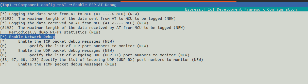

Postby esp-at » Mon Apr 01, 2024 9:16 am
could you please pull the latest master code, and enable the logs, see what happened~
You can enable the logs by the following steps:
python build.py menuconfig -> Component config -> Log output -> Default log verbosity -> Info
python build.py menuconfig -> Component config -> AT -> Enable ESP-AT Debug -> Enable Network Debug as the attachment p1.png shows.
