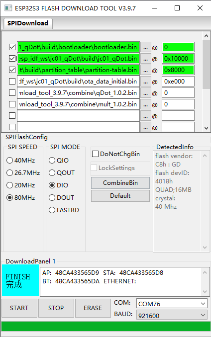

I'm having the same problem and am new to the flasher tool. I currently have the main.bin, partition_table.bin, and bootloader.bin selected. Are these correct? Thanks
it's correct, just notice the configuration of SPI flash. it is need to match the SPI flash configuration on your IDF.
