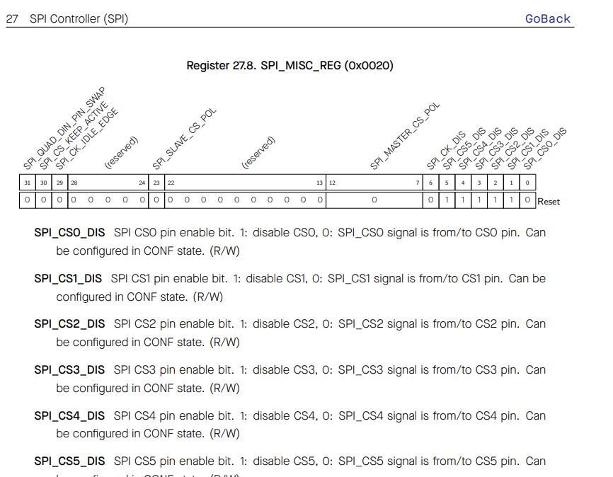

i use a c3 in spi master mode.
which register must be write to handle the cs pin by my self?

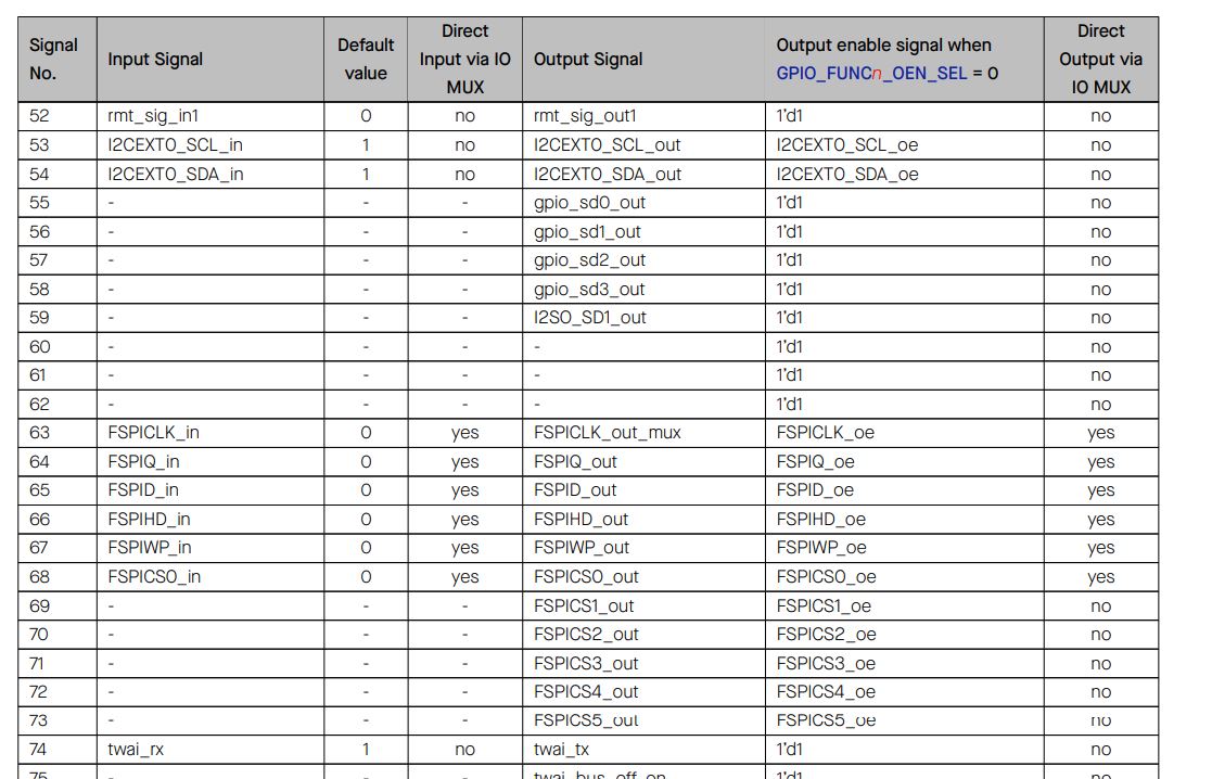

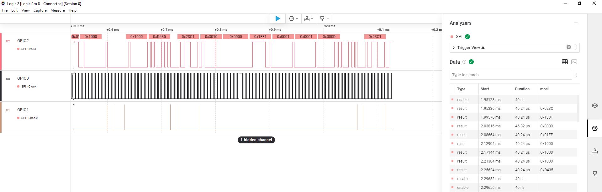

i have try to disable the mapping for FSPICS0 but i become a cs from about 40ns (see picture)
thx

watch TRM
disable in spi registers
esp32c3 trm
or do not connect in gpio iomux/matrix
or set gpio level to 1

i allready have try this, have you seen my picture in #1?
there you can see short spikes.. i dont no why^^

if you get this picture after this
#define CS 1
gpio_reset_pin(CS);
gpio_set_direction(CS,GPIO_MODE_OUTPUT);
gpio_set_level(CS,0);
look for external sources of interference
this code completely disables all interfaces and sets logic 0 on the CS output (GPIO1).
