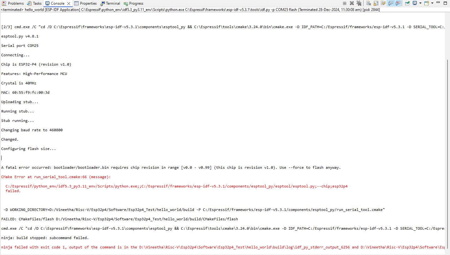

I have started working with the ESP32P4-Function-EV Board, and the IDE being used is Espressif IDE (v5.3.1). I successfully created and built the project, but when I attempted to flash the code into the ESP32P4 device, it displayed the following error:
Please help me to solve this problem.

Based on the output your devkit has already V1.0 of the ESP32-P4. My understanding is that you need at least IDF 5.3.2 for this chip revision to work.

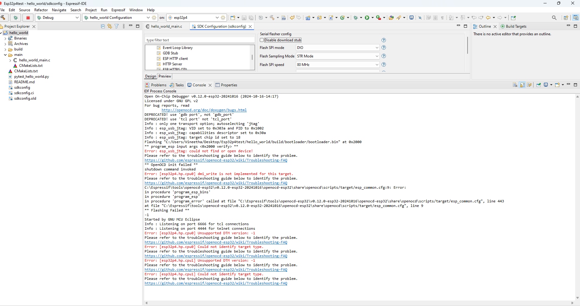

I resolved the previous problem. Now I am facing another issue with debugging. When I start debugging, it shows the following error.

Vineethad
Posts: 62
Joined: Wed Jul 19, 2023 7:45 am
Re: Failed to load code into Esp32P4 device
Postby Vineethad » Mon Dec 30, 2024 9:35 am
This debug log:
Screenshot 2024-12-30 112620.png (147.05 KiB) Viewed 945 times

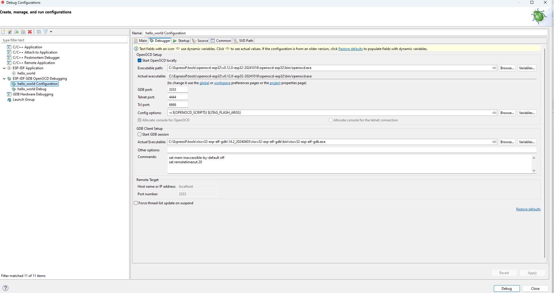

Vineethad
Posts: 62
Postby Vineethad » Mon Dec 30, 2024 9:39 am
This is the debug log:
Screenshot 2024-12-30 121819.png (94.37 KiB) Viewed 945 times
