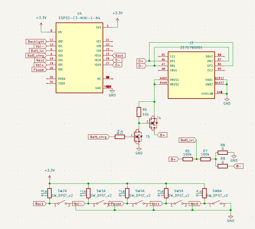

I have a custom esp32 c3 mini board and I was programming it and using it. Suddenly it stopped programming. It always shows on the same COM port, when I try to upload program it gets stuck on "Connecting...", then it shows:
"A fatal error occurred: No serial data received."
Nothing changed between failed and successful upload.

Hard to say, you're not giving many details. Can you post at least the schematics of your board? What was the last firmware you programmed into it supposed to do? What OS and Arduino version are you using? Are you forcing the C3 into bootloader mode in some way?

Before use I forced the board to go into the bootloader and then solder it on the board forgot to add IO8 pin on the board, so forcing it again means desoldering module (which I can do, if necessary). There is no RC delay circuit on enable (never needed it).
This is code after which it all broke:

And this is a image of important part of schematic.
Zrzut ekranu 2025-03-10 202751.png (61.77 KiB) Viewed 1122 times

If you don't follow the hardware design guidelines, then your behavior may not be reliable. In addition to the RC timing circuit, you should have gpio8 pulled up, and 5.1k resistors pulled down on usb cc1 & cc2.
