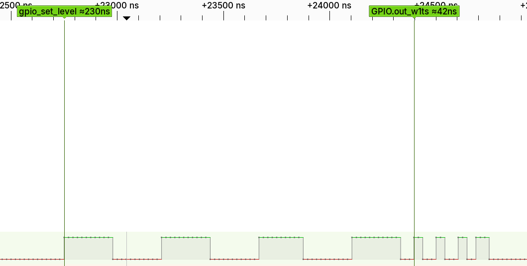

I made ≈333ns this way:
It's possible to down it to ~250ns, but not stable.
portMUX_TYPE my_mux = portMUX_INITIALIZER_UNLOCKED;
portENTER_CRITICAL(&mux);
// Set PD_SCK to HI level by bit set
GPIO.out_w1ts = (1 << GPIO_SCK);
// Wait ~ 300ns @ 240mhz
start = esp_cpu_get_cycle_count();
while (xthal_get_ccount() - start < 30) {}
// Shift bits left
value = value << 1;
// Set last bit depends on DOUT level (GPIO.in for 0–31 pin, GPIO.in1.data for 32–39 pin)
if ((GPIO.in >> hx711->dout_io_num) & 1) {
    value++;
// Set PD_SCK to LOW level by bit clear
GPIO.out_w1tc = (1 << hx711->pd_sck_io_num);
// wait ~ 300ns @ 240mhz
while (xthal_get_ccount() - start < 40) {}
portEXIT_CRITICAL(&mux);
PS. gpio_set_level 5.5 times slower than setting gpio level by register
gpio_set_level vs out_w1ts.png (17.11 KiB) Viewed 81 times

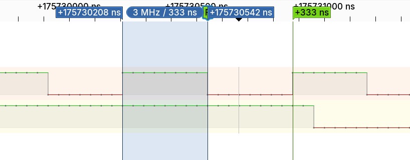

imShara
Posts: 10
Joined: Wed Feb 19, 2020 2:00 pm
Re: Could RMT split "rmt_symbols" by time, not by level change?
Postby imShara » Fri May 09, 2025 11:47 pm
And one more problem. When I push code into real enviroment with wifi an others - it seems like portENTER_CRITICAL not works as expected. Here is example - left side of clock is 24 bit read, right side - three bits for next conversion selection. And between this loops there is a long delay. Even if portENTER_CRITICAL used and even if portDISABLE_INTERRUPTS added.
one more problem.png (5.65 KiB) Viewed 73 times
portDISABLE_INTERRUPTS(); // No luck too
for (uint8_t i=0; i < 24 ; i++)
--- break appears here ---
for (uint8_t i = 0; i < 3; i++)
portENABLE_INTERRUPTS();
I thought it could work only on core1, separated from other hardware stuff.
