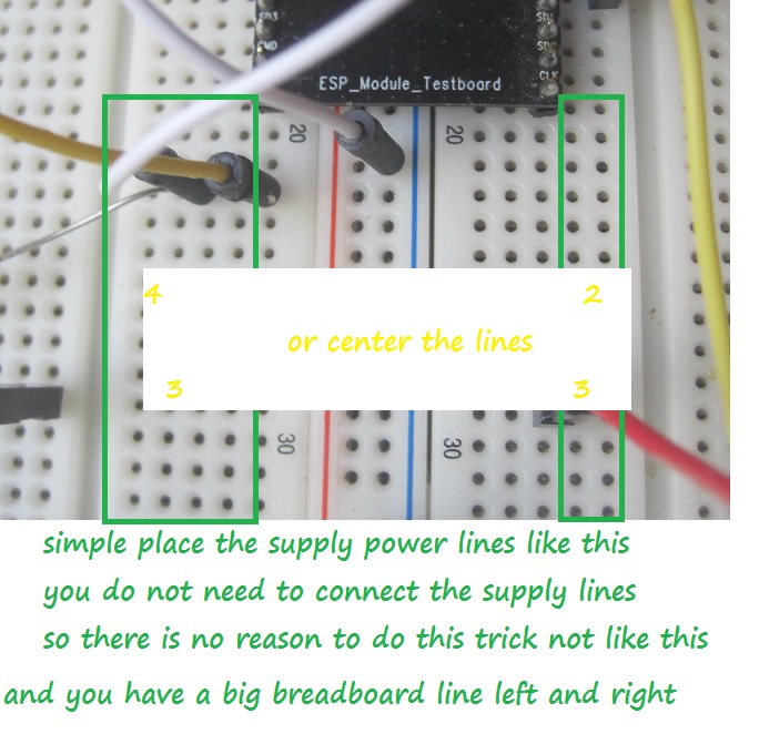

Too bad it's not "breadboard friendly" aka requires 2 breadboards. Hope to have mine in a few days. Time to play!
Posts: 1759
Re: esp32 devkitc getting started guide
Postby rudi ;-) » Thu Sep 22, 2016 11:55 am
no - take one breadboard, take the power supply in the middle between the breadboard lines -
then you have enough space.
Symbol Pic ( ESP32 )
this breadboard i took, this is not good to show the practice, but hope for understand.
there are breadboads with fixed pin lines and a space between, but there are breadboads you can "build your own design" any pluggable lines and can be combined like you need.
ps: yes it is time to play - but why only one? ;-)
let me know if you have one - then we can start together ;-)
i wait for the developer in the picture too, think same in few days is it here.
just in time at custom office for clearing - the delivery station is only 2 hour from me - hope i get it at weekend.
then its playtime and rock time.
