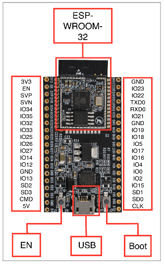

Postby rudi ;-) » Thu Sep 22, 2016 9:33 am
( edit 18 Oct 2016 - Figure 1.1 updated )
esp32-devkitc_getting_started_guide_en.pdf
ESP32
ESP-WROOM-32
This user guide introduces the basic features and operations of the ESP32-DevKitC.
PDF
V1.1 ( Octobre 2016 )
Getting Started
https://espressif.com/en/content/esp32- ... rted-guide
direct: esp32-devkitc_getting_started_guide_en.pdf
please do allways visit espressif resource site for update and newer versions!
source pic and note this link

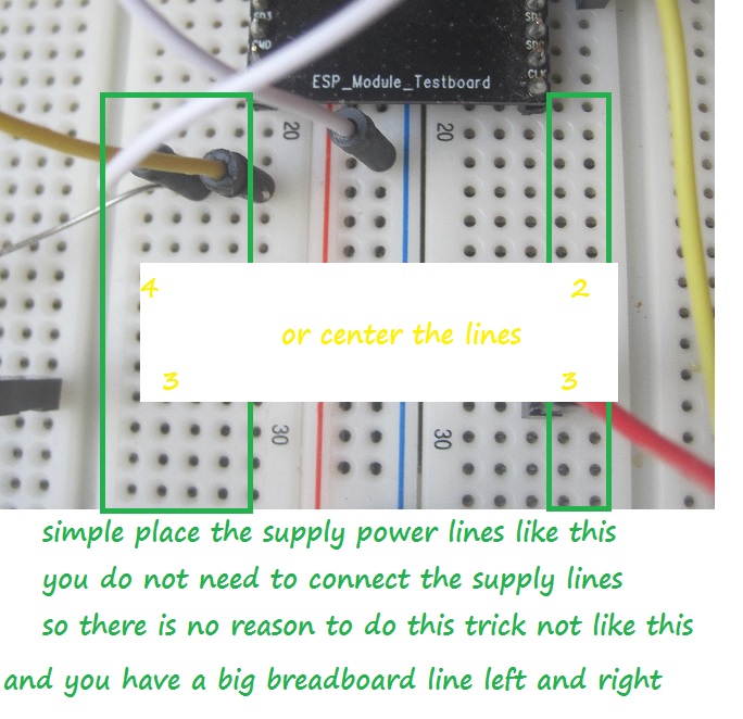

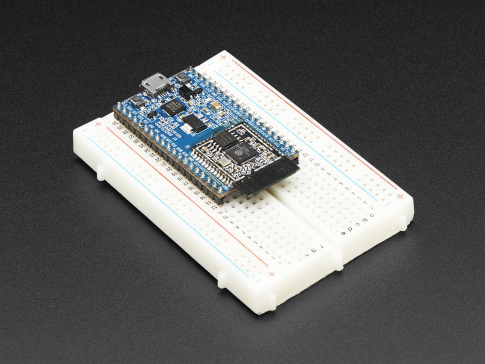

Too bad it's not "breadboard friendly" aka requires 2 breadboards. Hope to have mine in a few days. Time to play!

Postby rudi ;-) » Thu Sep 22, 2016 11:55 am
no - take one breadboard, take the power supply in the middle between the breadboard lines -
then you have enough space.
Symbol Pic ( ESP32 )
this breadboard i took, this is not good to show the practice, but hope for understand.
there are breadboads with fixed pin lines and a space between, but there are breadboads you can "build your own design" any pluggable lines and can be combined like you need.

Postby kolban » Fri Sep 23, 2016 12:47 am
I think there is an error in the ESP32 DevKitC Getting Started Guide. If we look at the labels for the pins, they are labeled (in the document):
* 3V3
* EN
* SVP
* IO34
while on the actual board they are:
* 3V3
* EN
* SVP
* SVN
* IO34
I think its a simple mistake in the annotation of the diagram, but one that should likely be fixed.

Postby kolban » Mon Oct 17, 2016 3:13 am
Guys,
A second error in the getting started guide. Look at the label of the pin just north of the 5V line on the left. It is labeled "GND". It is not GND but actually CMD.

Postby Sprite » Mon Oct 17, 2016 4:47 am
Fyi I poked our techwriters to look into releasing a corrected version.

Postby Sprite » Tue Oct 18, 2016 9:56 am
...Which they have posted: http://www.espressif.com/sites/default/ ... ide_en.pdf
Rudi, would you mind modifying the image in your first post to the corrected one?

Postby rudi ;-) » Tue Oct 18, 2016 3:05 pm
yeap , done .
